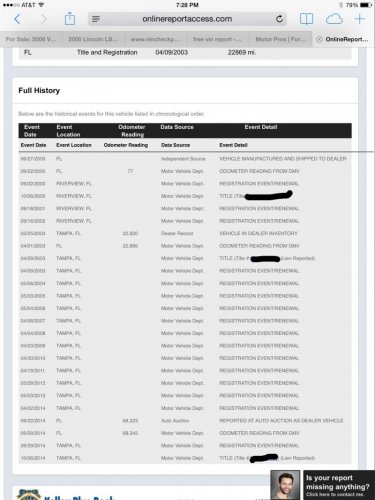

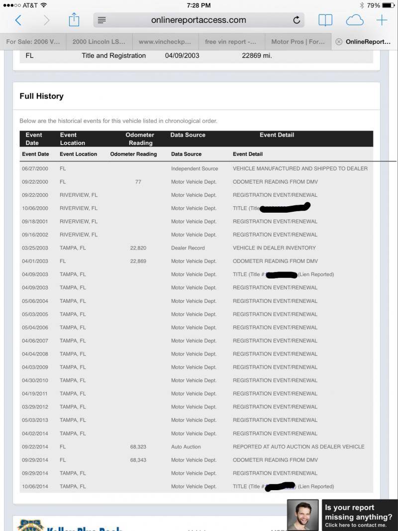

Thats some low miles for a 00. Nice
One of the main reasons I bought it was the low miles. The first owner drove low miles and the second owner drove even lower miles. WOOHOO!

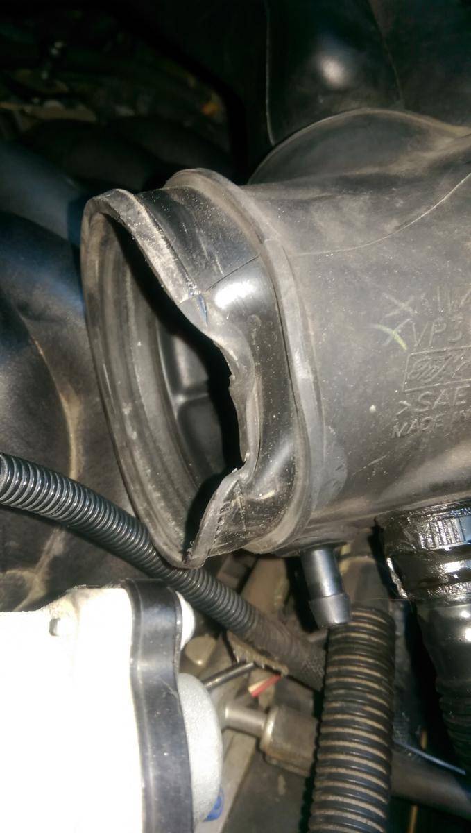

Found what was causing lean condition making idle janky...Heat gun fixed it....my guess last guy putting in air filter was in a hurry
Just in a hurry? With what, the Jaws of Life? Was it installed by a fire truck?
Lol...would be easy to screw that up though...it's tight, you can't see, and well, most people working at jiffy pit are one step away from "ding fries are done"

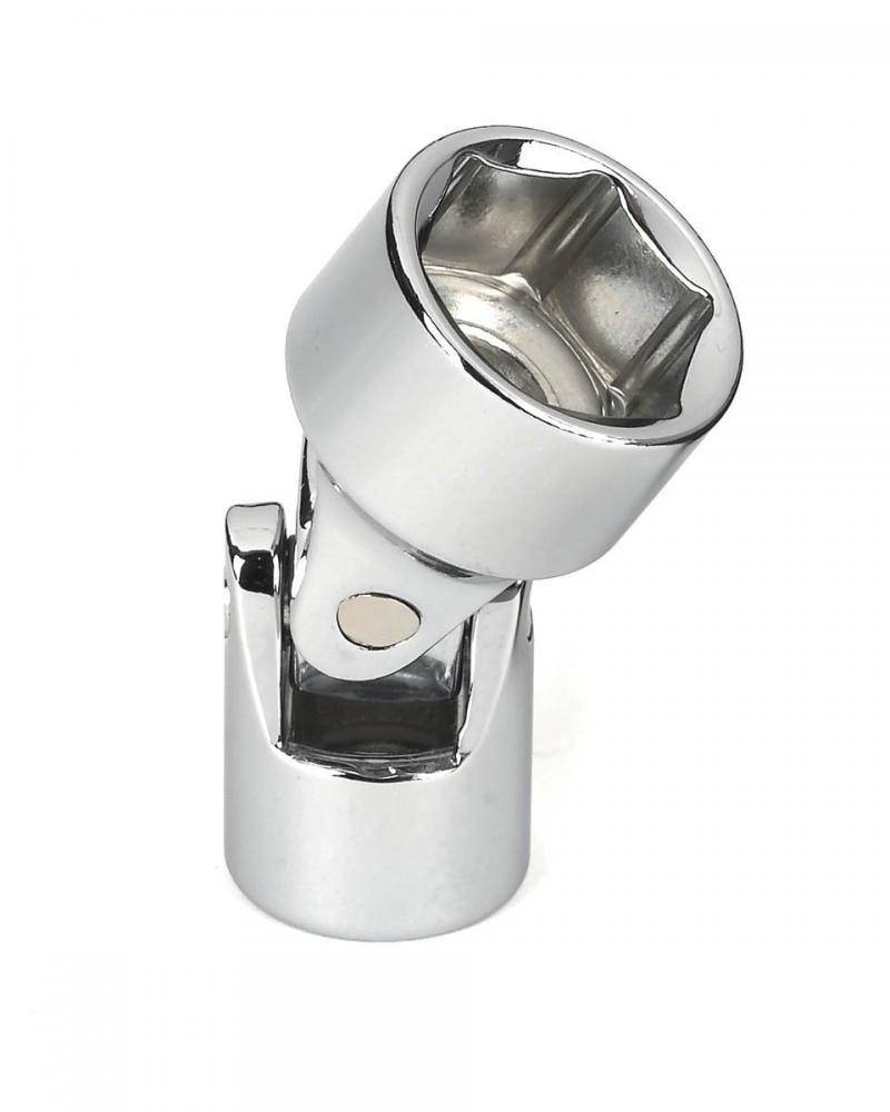

Any thoughts on leaving the back bottom bolts off of the covers? I dont think it would hurt anything.
<img src="http://www.lincolnvscadillac.com/forum/attachment.php?attachmentid=828470622"/><img src="http://www.lincolnvscadillac.com/forum/attachment.php?attachmentid=828470623"/>
Get yourself a little gear wrench. I have one that is 7mm and 8mm. Flip it over to loosen and flip it back to tighten. Use fingers to get it as far as you can then use the wrench to secure it.
