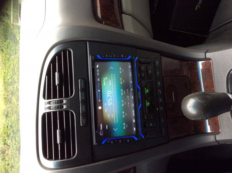

What did you have to do to instal that bad boy
remove some trim panels
remove old radio
mount new radio into dash kit
wire up radio harness to a car matching aftermarket harness
plug in new radio
reinstall trim panels

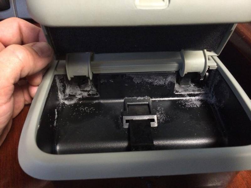

I am trying to clean this out. Anyone else seen this? It's almost like adhesive. Gonna have to get out the lighter fluid.
I had to pay the man at Best Buy. LOL
I did order the dash kit off of Ebay for 13.00. The dask kit came with the female wiring harnesses.
I had to dremmel down the dash kit to make it fit the radio. It messured originally 100mmx108mm I had to take off about 2mm on each side to end up with 104mmx112mm aprox.
Eonon double dins are notoriously big. Its from the UK. I didn't think I would be able to use the radio function here in the US, but was pleasantly surprised that it works. WOOHOO!

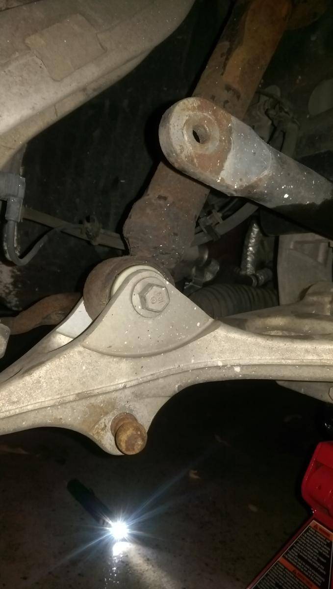

first project on this 03 V8 that I got on a flip - PO had hacked out the swaybar end links - leaving the stubs! well, that's solved...one problem down, several to go. Next step - inner and outer tie rods.

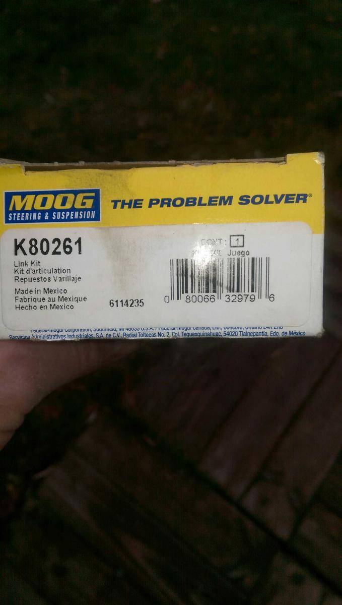

Those look nothing like Moog links. Mine look completely different. So, unless Moog changed their design, those are another brand. I cant imagine Moog would change the design for cars that dont exist anymore but stranger things have happened.
