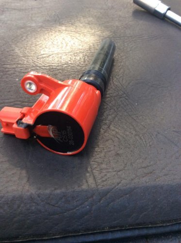

Couple things today......

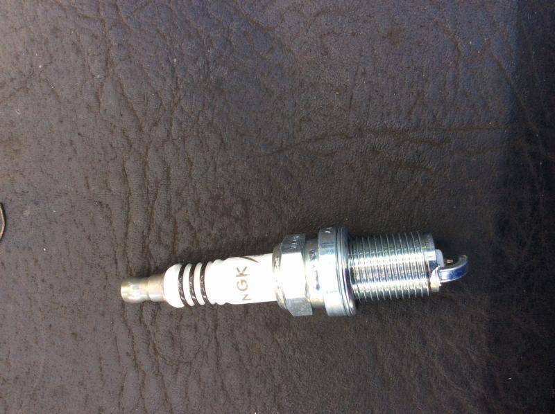

1. New coils and plugs.

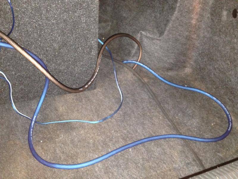

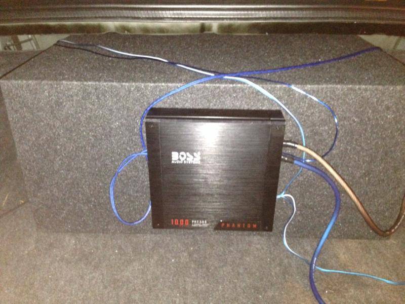

2. Hooked up the amp and 2 12s

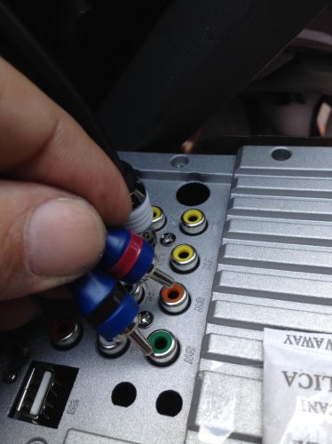

3. Added aux cable for playing music since Bluetooth sounds like caca
1LoudLS.........The fuse is 12 inches on the positive cable from the battery under the spare cover. :Beer
Here are pics for proof of today's activities:

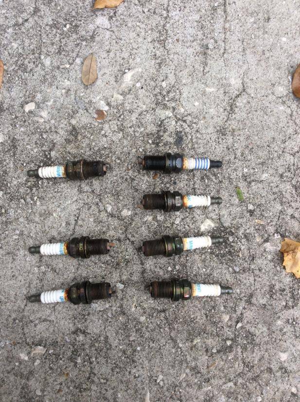

Here are the old plugs and some coils. There is only seven plugs because I replaced the one that was giving misfire codes a few weeks ago.
A mix of originals and replacements:
Apparently I had one original from the factory still:

one thing I would at least try out would be to turn the sub box around and have it face the rear of the car and see how it sounds. a lot of the time when the subs face forward, you can get conflicting sound waves that will cancel a lot of themselves out. then again, sometimes they don't...
having the subs face the back usually keeps all the sound waves aligned and will produce a much louder and deeper sound. usually if the subs face the front, you want them to be as far toward the back of the car with as little space behind them as possible.
