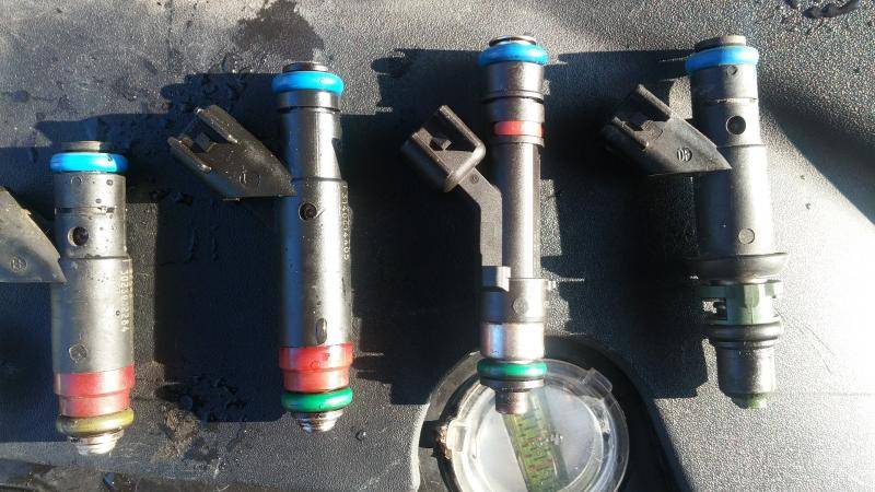

Goodbye to the injection system with air support and well come to the injection of 4 points,after rough it with huge air leaks I decided to remove the air assist system.
Left to right
LS 2 Gen
2003 Ford Taurus
2004 Crow victoria
LS 1 Gen
I use the the 2003 Ford Taurus those are the best suited for the size of ls 2Gen are very short for the base of the ramp injection and victoria are have a lot of fuel flow these may be useful for a turbo compressor project.
