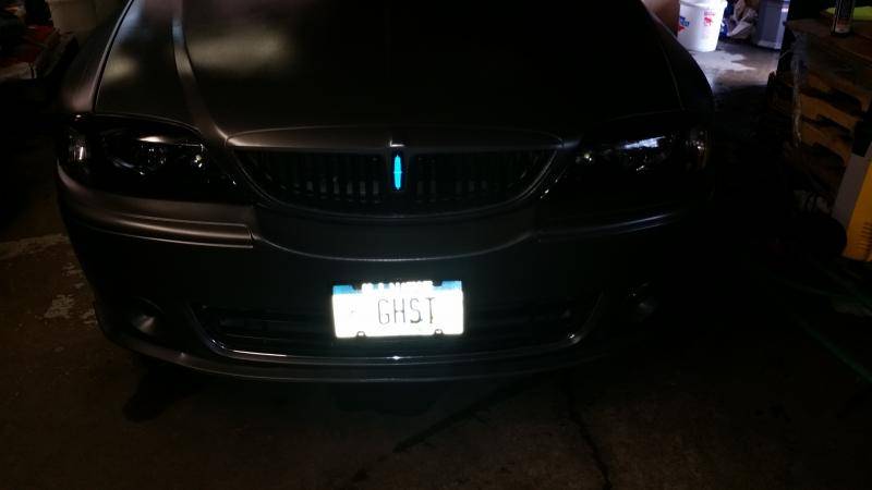

Thank you. They are the originals. When I pulled them off to paint the grille and surround, I sanded the black off the back and painted them red. Certain I read that on here somewhere.
The grill insert is gutter guard from Lowe's. Was under $3 and was just big enough to fit, with some trimming of course.

Is that the reflector emblem? I might be coming around on my opinion on it..

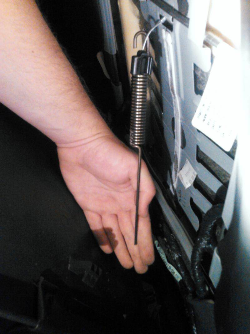

But today I made a little bit of progress. One thing led to another and I washed both cars and dechromed the driver side windows of the LS with the vinyl striping. Once I got a technique and rhythm going, it was pretty easy. I also pulled off the rear cover of the driver seat and found my suspicions to be true: the little metal hook I found under the seat when I first got the car is, in fact, from the lumbar spring. Should be easy to fix next time I'm around a junkyard

Is the lumbar support piece adjustable up and down? I feel like mine sits super high. Definitely above my lumbar.

Most likely not. It's just a flexible sheet of metal that the cable pulls down on to bend it outward. If you really wanted to, maybe you could brace the upper portion to stiffen it so it can't bend. That should move the peak a little further down

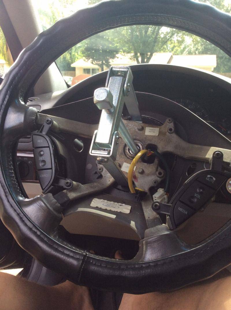

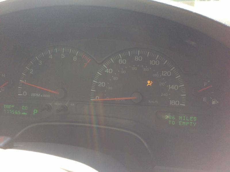

So I did the clock spring today. Got all my media buttons back....YAY! Will test the cruise control later but I'm sure it's a go as well. The horn definitely works again. Nothing scarier than a big truck coming into your lane and frantically hitting the horn to no avail.
It's not a corolla!
But I still have the airbag light. Giving me a blinking code of 36. It was 26 before IIRC. May not have been. But I want to think it was. Grrrrrrr. About to run new sub lines and backup camera feed to the radio.
...But I still have the airbag light. Giving me a blinking code of 36. It was 26 before IIRC. May not have been. But I want to think it was. Grrrrrrr. ...
I don't know what LFC 26 would be. 36 is Driver Side Air Bag Circuit Shorted to Ground. It could be the air bag itself, it could be wiring, it could be the RCM, or it could still be the new clockspring.
Could this be the little yellow wire situation under the driver seat I read about a while back?

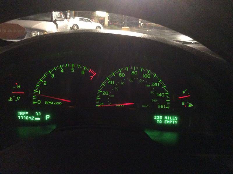

Actually, the airbag light isn't coming on anymore.Maybe there had to be some type of cycle in the system? Hmmm

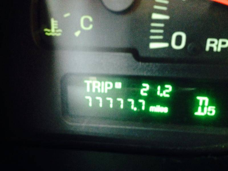

This happened this morning on the way to work.....:wave
Lucky 7's
