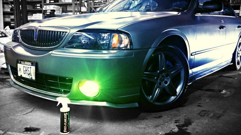

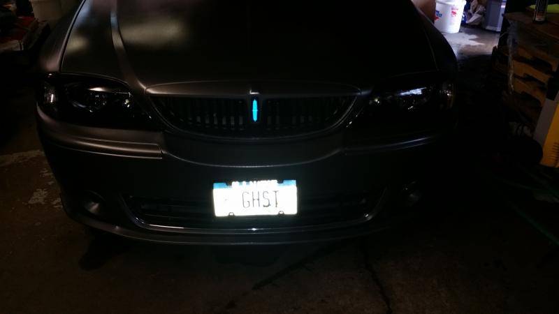

Yes sir, I wash ,waxed the car ( meguiars spray wax) and used perfect surface (fast n flawless) to make it butter smooth

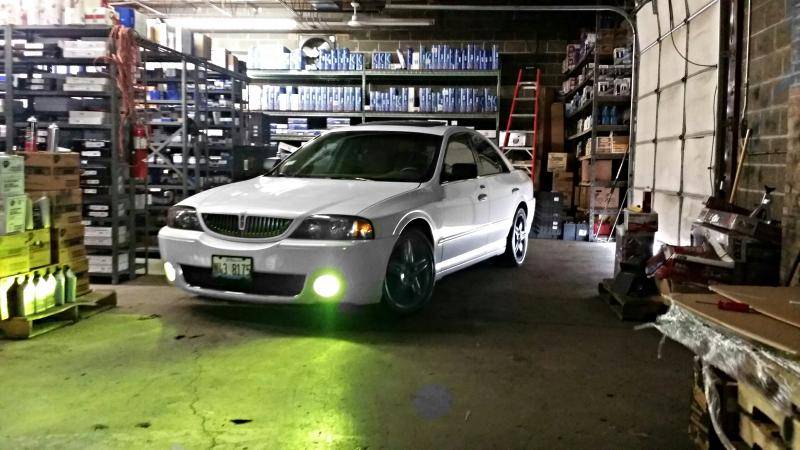

Used to have another member on here that always showed pics of his LS inside a parts garage/storage like that. If I didn't know any better I'd say one and the same person.
Looks good, was not aware one could apply any polish to a dip, though it was wash only.
there are a bunch of excess stuff you can do to keep it smooth and clean , most people just don't do it , and if this is the a$$hole you are talking about then yes it is me haha

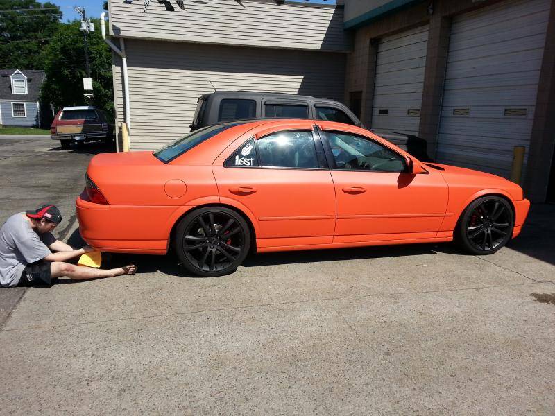

man I have really been struggling to decide which color I want to dip my LS in... I've been torn between antricite, stealth bomber black or koi orange. while probably my favorite option is the koi orange, its probably out of the running just because I dont want to be cop bate!
f*ck beans I wish I didn't drive a little fast all the time! that would be awesome!!

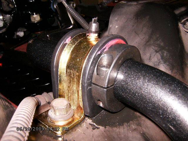

I changed the oil and filter, the engine air cleaner and the a/c cabin filter as well as the fuel filter in my '04 V8 Sport over the weekend. I still need to install the fresh set of spark plugs along with new COP boots and then get around to installing the new pair of rear toe links and get the car aligned.
Since the front end was up in the air, with the driver's front wheel off, I tried to see if I could track down the source of the irritating squeaking noise that has been getting worse. It turned out to be the sway bar mount bushings. I did some researching and then ordered a set of Energy Suspension 9.5171G bushings off eBay along with a pair 1-3/16" 2-pcs clamp on shaft collars (aka split collars) from McMaster-Carr to hold the sway bar in-place side to side.
The setup will end up looking similar to this photo that I found on the Mark VIII forum.
Here is my write-up on the install with photos;
http://www.lincolnvscadillac.com/fo...n-II-V8-Sport-replaced-front-sway-bar-bushing

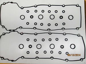

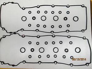

I got the valve cover gaskets today, Felpro VS 50724 R FOR A GEN 2 V8, can anyone tell me if I should have 4 of the larger spark plugs tube seals or 8 in this kit? I would assume 8 from the few pictures I can find using the search but every thing has ben gen 1 picture wise on here and I've never torn into one of these before. Want to make sure I have everything before pulling the covers. I have 4 larger tube seals, 28 grommets 1 o-ring and 4 smaller grommet/seals.
going off this pic on fleabay I am missing 4 of the larger tube seals $_35.JPG
8 cylinders means 8 spark plug wells means 8 spark plug well gaskets
