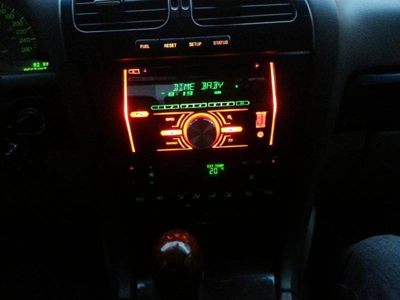

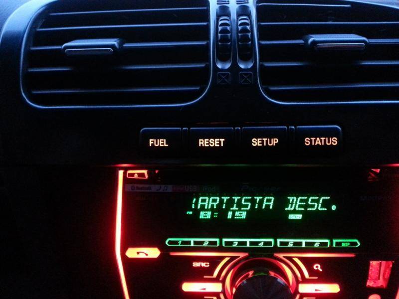

Hi!

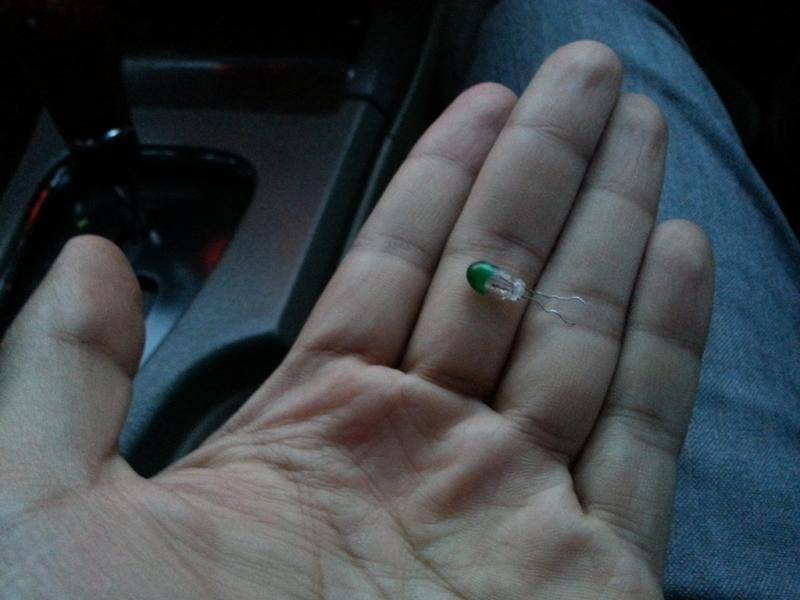

I replaced a light bulb ,it went bad when i removed the msg center switches to install the radio.
I thought it was a special bulb but it's not, just a 12v light bulb with a kind of green silicon cover.

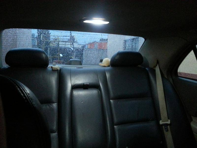

LED lights convertion.( The dome was crispy ;) , so much heat from old bulb light.)

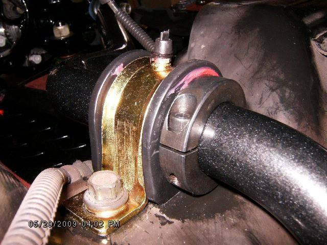

Since the front end was up in the air, with the driver's front wheel off, I tried to see if I could track down the source of the irritating squeaking noise that has been getting worse. It turned out to be the sway bar mount bushings. I did some researching and then ordered a set of Energy Suspension 9.5171G bushings off eBay along with a pair 1-3/16" 2-pcs clamp on shaft collars (aka split collars) from McMaster-Carr to hold the sway bar in-place side to side.
The setup will end up looking similar to this photo that I found on the Mark VIII forum.

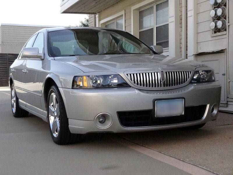

Got around to putting the eyelids on. Sits nice and flush, painted by a local bodyshop for ~$60.
So sleepy......
Looks great!
