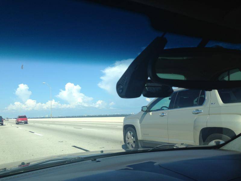

Here are some pics of the dash cam from my perspective. I couldn't get a good shot of it from outside the vehicle. I'll have to try in full sun. I always find myself parking under trees or in garages wherever I go. Black cars and the sun don't mix well. I'm sure you can identify. :)

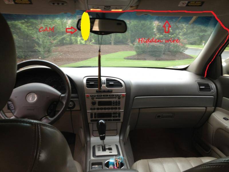

I would like to know about power wire location and where it was put to hide ?

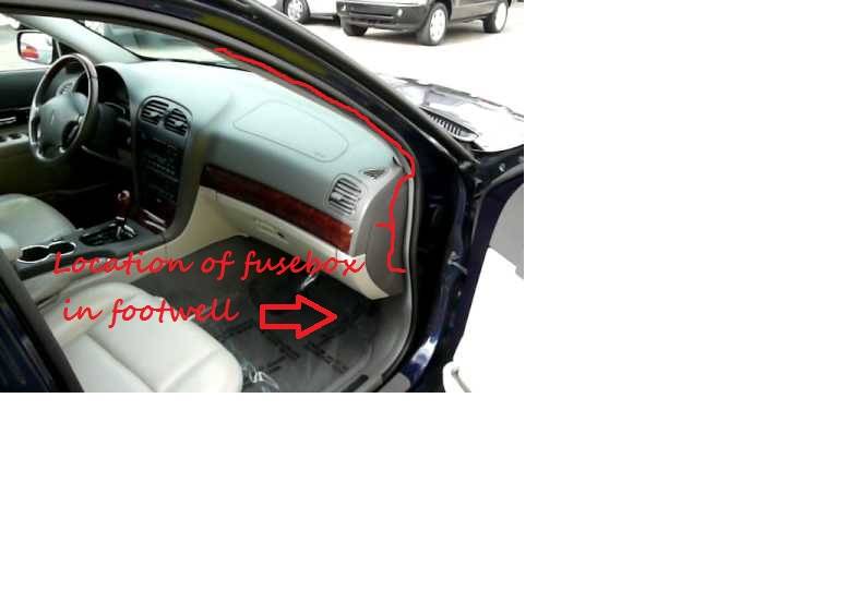

Here are some pictures on where I hid the power wire. These photos are not my car, they are from a google search. I just drew on them. LOL
The power wire comes up from the cam and tucks behind the edge of the headliner and then across the top of the A pillar cover the under the weather stripping that runs down the edge of the door frame and then behind the little space between the door frame and the dash. You can pop off the cover on the edge of the dash. I mounted the ground wire to the first accessible bolt behind that cover.
The fuse box is on the inner side of the floorboard on the righthand side towards the front of the car. There is a little door that you have to pop open and then pull the cover off the fuse box. That's where the fuse splitter will go.
