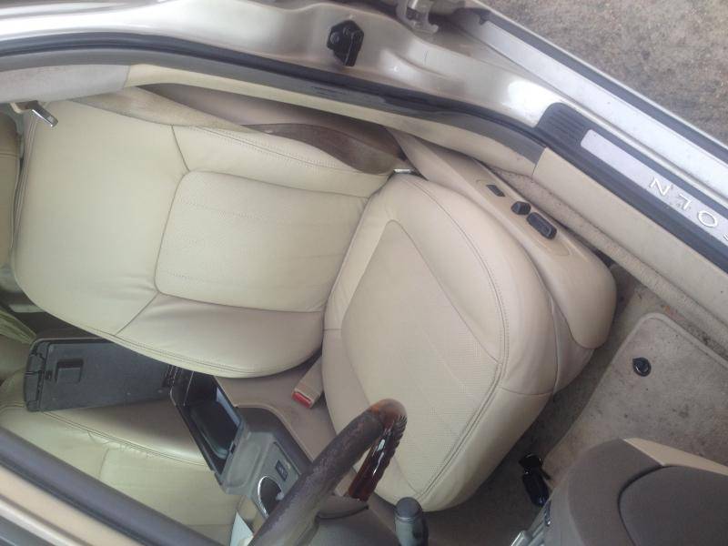

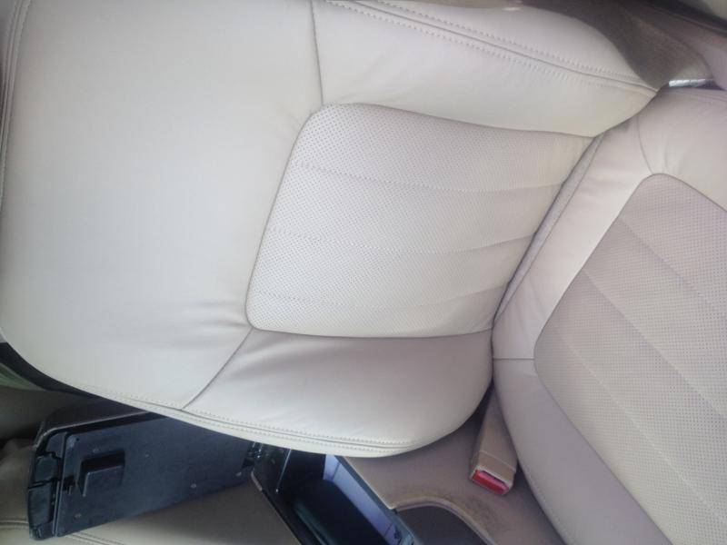

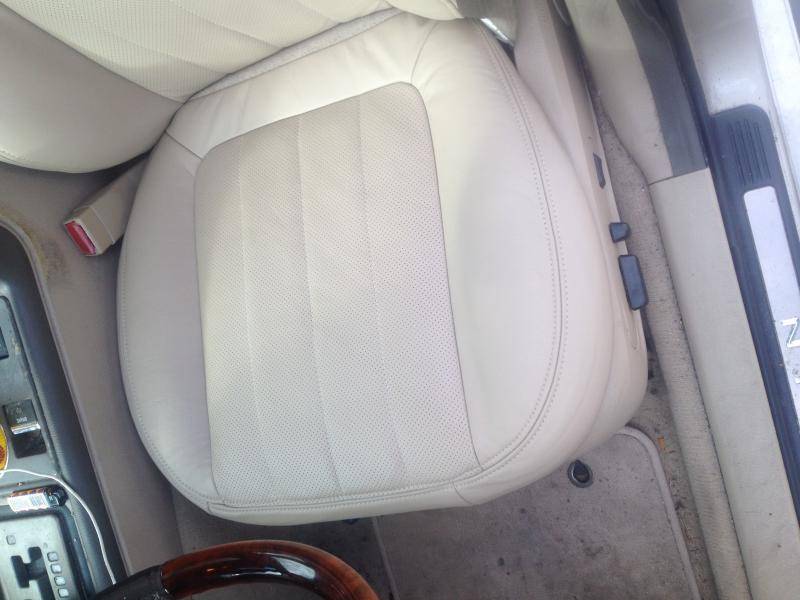

Replaced my rear splash guards. Had my drain holes unclogged. Oil Change, refilled coolant, Bring in to upholstery shop in the morning to get my drivers set re covered to the tune of $708. They dont re wrap steering wheel so I'm looking of for a replacement wheel to get back to new status, since the leak from the sunroof degraded the leather. Filled up with 93 with no ethanol. Sprayed wheels with the shiny stuff. Still have an ash tray that won't stay closed and mats that need severe cleaning or replacement. Need to change out a slightly cracked drivers side rear visor shade/ wind deflector.

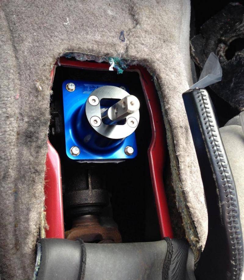

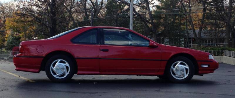

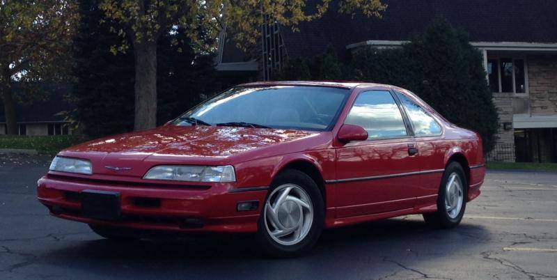

I know it's not my LS, but since my wife drove the Lincoln to work today, I couldn't start my rotor & caliper project. So, I pulled the Super Coupe out & put a B&M short-throw shifter on, as well as clear corner lenses.
That shifter made a HUGE difference over the stock one.

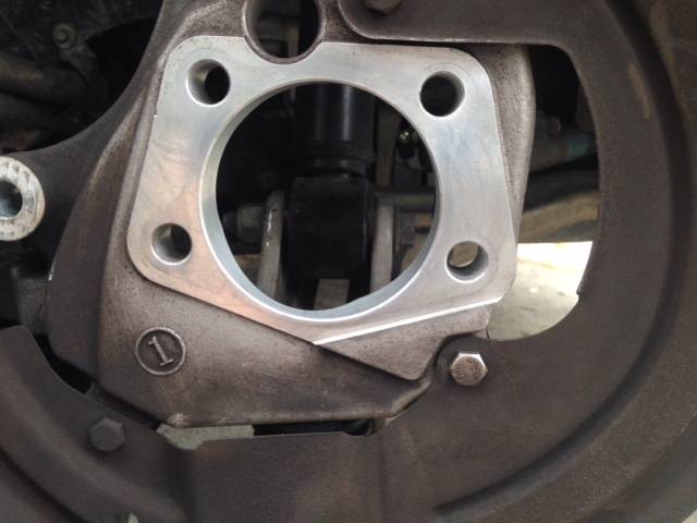

I did my wheel hub assemblies up front and brake pads. Went to ceramic. Got tired of cleaning the whees all the time. This is the only picture I took cause I was covered in brake dust and grease. But the assemblies popped right out. Didn't stick one bit, either side. :)

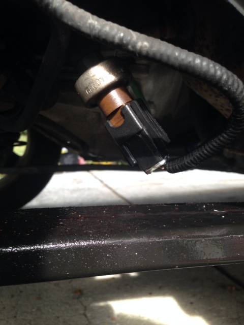

Also I have found the source of my power steering leak.......It is coming through the plug itself. This can't be good. I don't even know what this is called. I couldn't get up under there enough to see the part number. Only partial part number from the piece its connected to of ?????-3n824-aa0039. I already bought the Power Steering Pressure Sensor, but it looks nothing like this one.

izzy, what brand hubs did you put on? not those from Prime I hope!

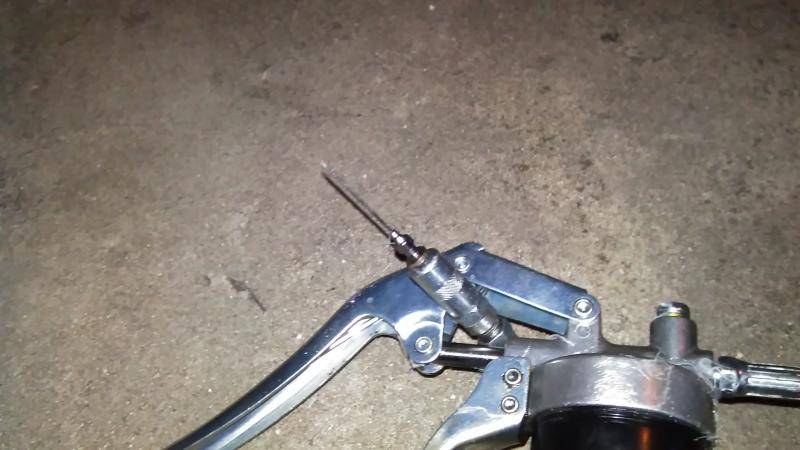

If you have a grease gun, you can buy a needle attachment and feed grease through the boot to give you some more time.
