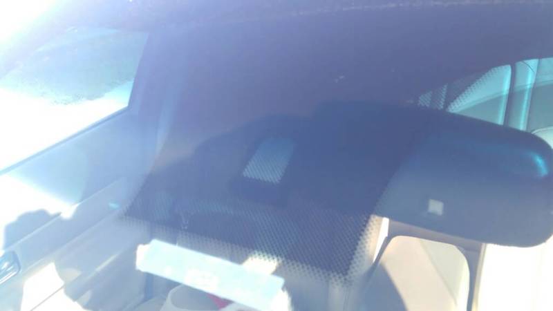

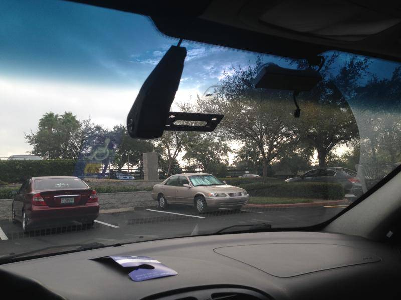

I adjusted the viewing angle of the rear view mirror and the fvcker fell off. Oh well, at least it matches the auto wiper sensor right? b@stard. Well, I guess it will be worth a try to remount them both. They both took little chucks of glass with them. If they don't stay up then I will have to see about getting a new windshield. I bet I could get one of the neighbors kids to throw a big rock for $5.
... had me laughing!!!
sorry to hear... havent seen that to much with the LS... Getting it back up there AND STAYING may be tough. GL
Glad I could help with your jollies today. LOL...... Here in FL the sun and heat gets to the glue. Every single car I have ever had, this has happened to. So I'm kinda used to it. I think I am going to go the $5 rock route. It isn't the original windshield. I wonder if I can get the Lincoln glass anymore. I will have to call around to find out.
Make the calls from payphones from different parts of the city, then the 5$ route, only then phone insurance from home/personal phone.
Never leave a track izzy! LOL ~ btw, why not check with glass installers and see if they have the magic glue and will do it for ya.

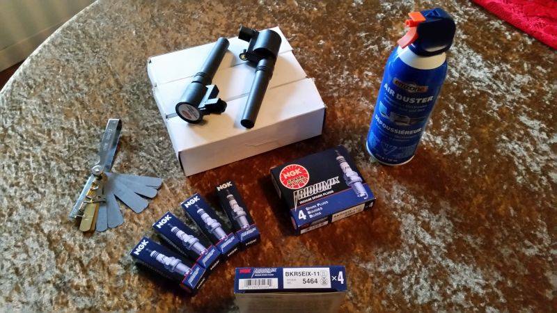

On a separate note: Plug #4 was an old original Motorcraft, #3-2-1 were upgraded NKG's but the G-Power Economy variety. * May not meet OE Standards * Gaping looks huge, I'll get to checking that soon as the new ones are going in. #4 Plug broke loose too easily compared to others.

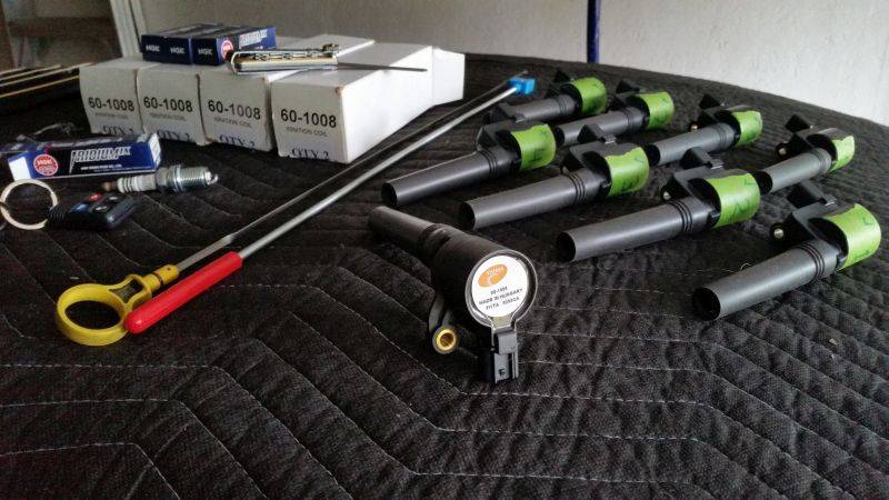

:: Play-by-Play Lincoln LSE Coil & Plug replacement coverage.

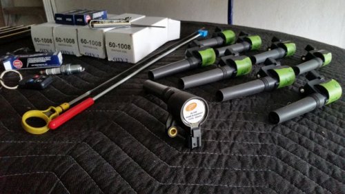

Sorry just dumping some pics,
gotta head into work shortly and start the Pete for another weeks trip.

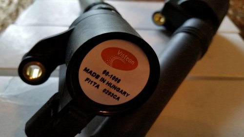

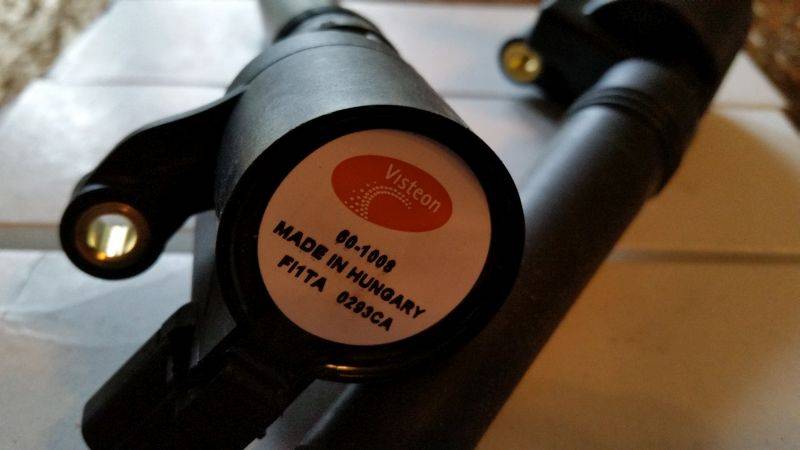

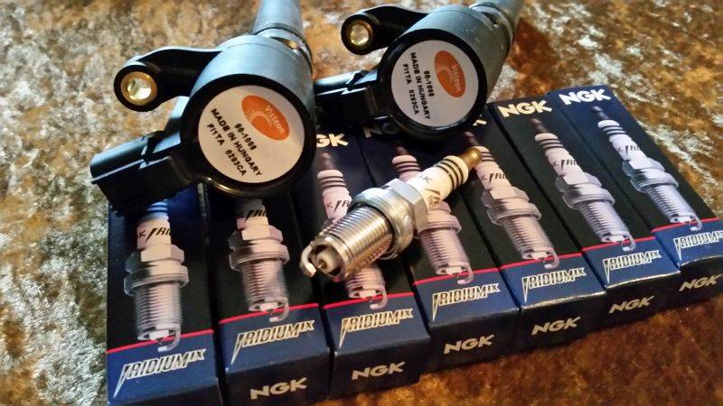

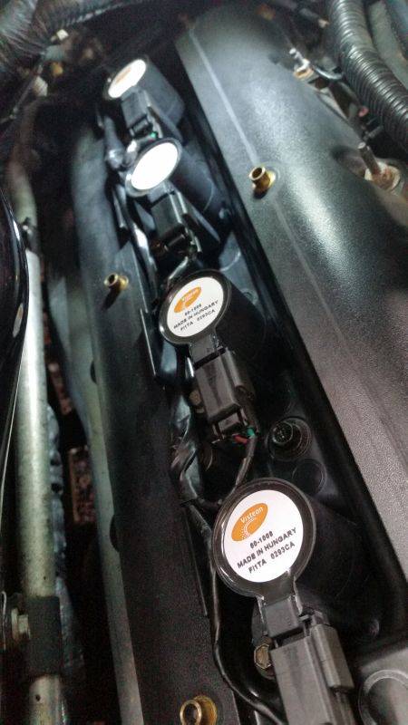

Pains me to separate with these nice Visteon coils. Can't get them anymore. Paid 220$ for all 8 couple years back.

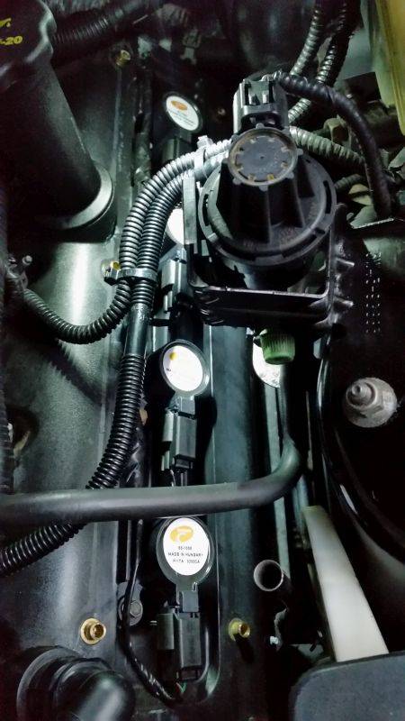

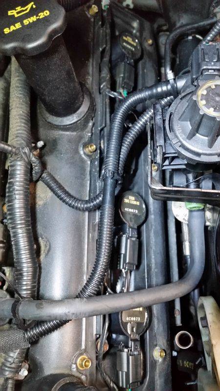

Passenger side, #4 was bad causing ETC fail safe mode. Original coils and #4 had Motorcraft plug while others had NKG GP's, below OE standards and all where over gaped. No oil or water in any of the plug wells.

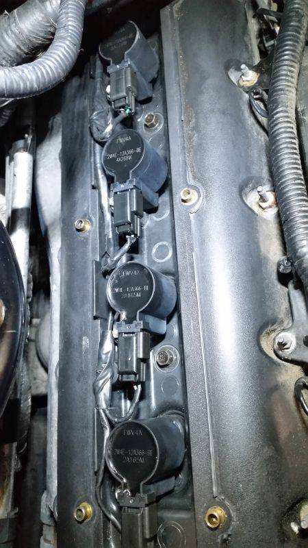

Drivers side, all but #7 had fresh coils, all had NGK GP's and over gaped. #5 seemed to give a misfire code on WOT. No oil or water in any of the plug wells.
Labeled all the removed coils, throwing #4 in the garbage, keeping others as known-good spares. Labeled #5 with a question mark.

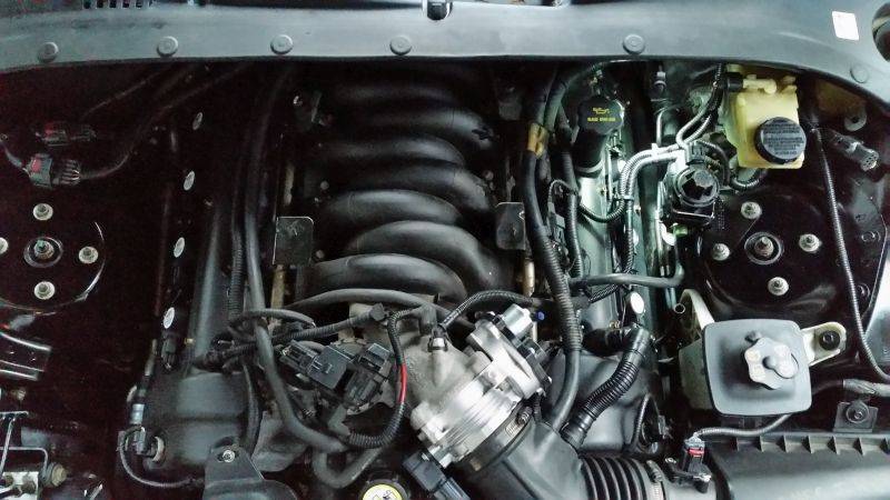

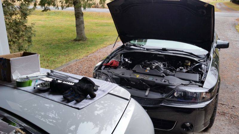

Little damp and humid to be doing this outside but the princess is taking up all I got for a garage.
Passenger side completed, all cleaned up, fresh coils & Plugs.
Drivers side completed, all cleaned up, fresh coils & Plugs.
All done, coil covers will go back on next week, want to give them a little color first. Car not being driven.
All in all, the dealerships threw a Throttle body & position sensor at it and informed the PO he would need a new PCM next.
ETC failsafe mode, P2107 and P2110 was due to failure of coil #4 freaking out the nearby PCM, ran like crap, after replacement of coil #4 with a used coil, problem resided but still overall a terrible idle. You could hear and feel it as it idled, WOT threw another misfire code on another cylinder.
All new top of the line coils and plugs gaped correctly with some di-electric grease in the boots cleared everything up!
Idles perfectly, runs like a raped ape, Wide Open Throttles like the day it left the plant.
Very happy with the outcome, have more to do to this LSE but end of the day, money well spend. :rolleyes:
I'm sure the entire cooling system will need a few hundred soon enough and I'll be replacing some suspension parts as well.
Little touch up on the cosmetics here and there and it should give my other LS'es a run for their money. :cool:

I got the rearview mirror back up on the glass. But the auto wiper sensor, when I put it back up, doesn't line up correctly with the spot on the windsheild. We will see when I get home and throw some water on there.
