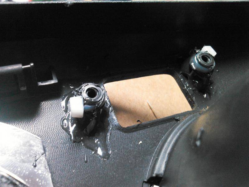

I ended up preemptively going after this failure today
I'm slow moving, but I just checked out the AT switch mounts. They were already cracking, as it turns out. Today's cocktail is JB and zips (I figured the zip ties would give more compression strength than epoxy)

Also, the bottom of my cupholder is gross.

that should hold real good! good thing you checked it out, its always nice to catch something like that BEFORE it breaks!
did you check you parking brake switch too?
EDIT: nevermind, I see you have a 1st gen...
Pro Tip for anybody else that has an LS, even if you message center buttons, AT/TC button, or parking brake switch inst broke, you should probably take them all apart and check them out and have a look and make the above repairs before your break, I'm pretty sure they used the same brittle ass plastic on the interior as they used in the cooling system!
Yep, I hope so. Thanks for the tip before. I might not have noticed the cracking had you not said anything. It seems like JB Kwik doesn't adhere well to plastic, though. I think it was necessary for the Message Center buttons since I was bonding with metal, but this probably could be better with proper plastic epoxy. That being said, I have a lot of faith in the ziptie holding the cylinder together and the JB holding the ziptie in place

The bolts and metal plates looked fine to me :)
