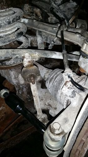

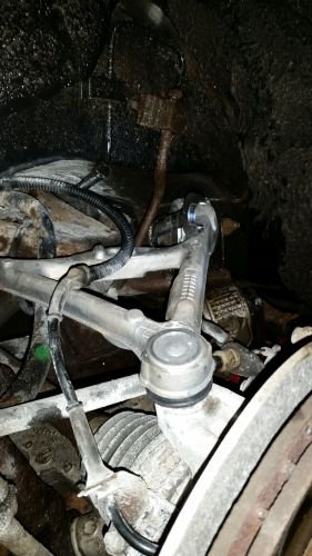

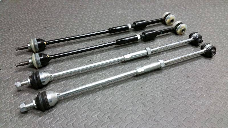

Over the last couple of weeks, took delivery of two sets of Rear Toe Adjust linkages,
one set is OEM for the wife's 03 LS, other set is the non-passive steering JAG aftermarket sourced from the UK for my 04 LSE.
Although a bitter cold and dirty job,
last night got the new OEM Upper Control Arms and Passive Steer Toe Adjust linkages in the 03 LS.

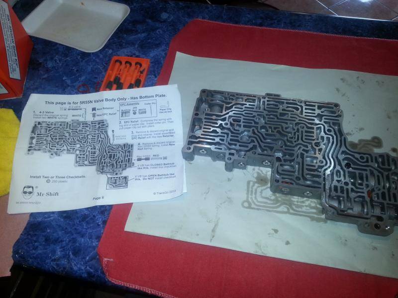

waiting to install the tranny.
transgo shift kit installed.
