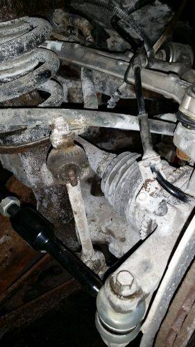

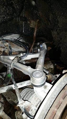

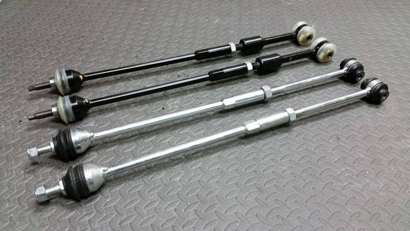

Over the last couple of weeks, took delivery of two sets of Rear Toe Adjust linkages,
one set is OEM for the wife's 03 LS, other set is the non-passive steering JAG aftermarket sourced from the UK for my 04 LSE.
Although a bitter cold and dirty job,
last night got the new OEM Upper Control Arms and Passive Steer Toe Adjust linkages in the 03 LS.
View attachment 828474979 View attachment 828474980
So what are the details on the non-passive steering JAG aftermarket sourced from the UK links?
Want all my secrets do ya? :p
Here: http://www.ebay.com/itm/JAGUAR-S-TY...ash=item20ce731af0:g:voMAAOSwnDxUhvdU&vxp=mtr
and here: http://www.rimmerbros.co.uk/Item--i-XR825750P <-- $45.10 USD per unit.
Ended up getting them from Rimmer Bros as the price was a little cheaper and the first eBay guy after a few days was not interested in replying to my international shipping charges inquiry request.
A little bit for shipping and Canadian Duty collected at delivery by UPS. Rimmer Bros collected the VAT charges on check out. (or I think were included in the price)
BTW: The welds and boots are identical to the previously available black DEEZA links, I took notice of this by detailing the entire links in pics before ordering plus comparing to my DEEZA links in my 01. The welds are identical and in the same spots. To me the only thing different is one got black paint the other did not. Same DEEZA links, EURO market. I'd be willing to bet on.
EDIT - - -
To my surprise, from the UK, they were at my door just after a week. Not bad for "from-oversea's". Actually arrive to Canada before the Tasca OEM's did.

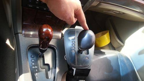

Shifter swap!
