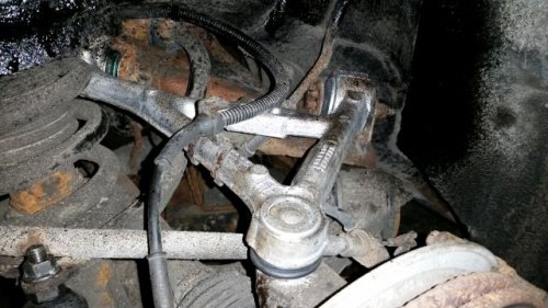

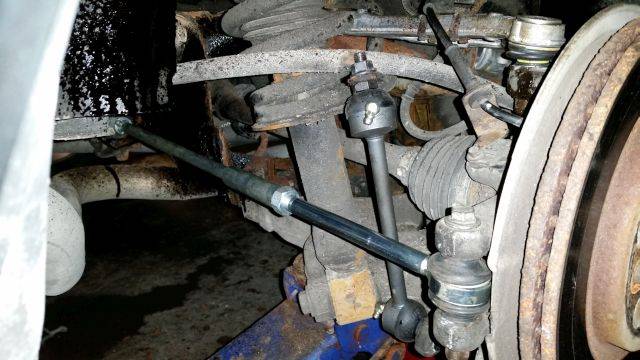

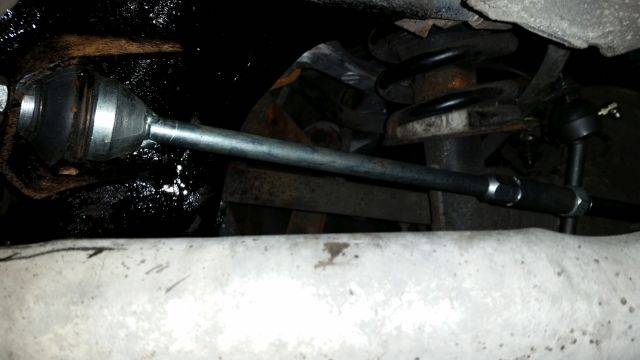

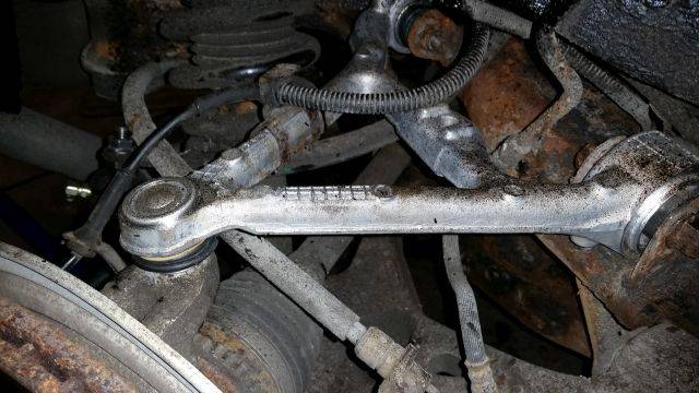

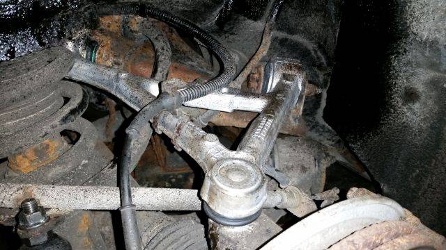

Couple of pics of last nights mess.

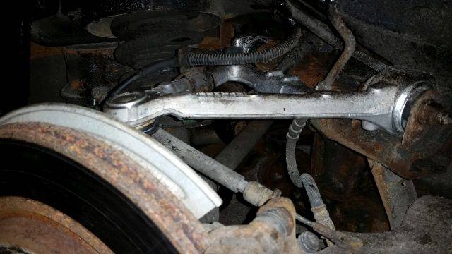

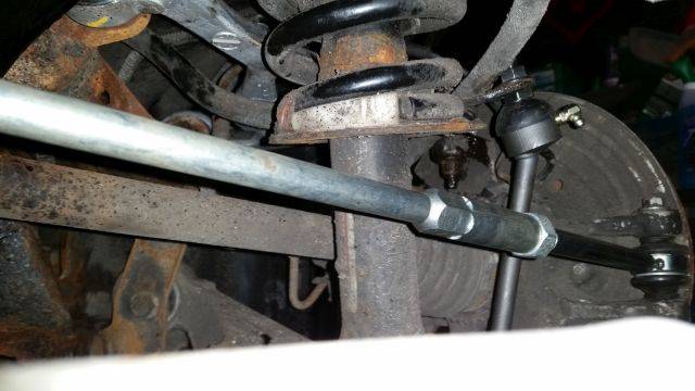

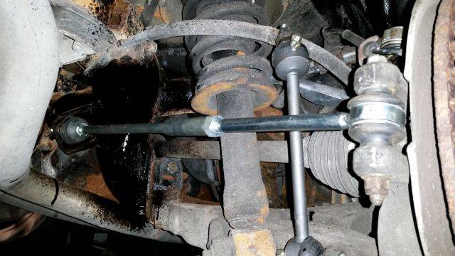

04 LSE got new rear OEM Upper Control Arms, JAG Aftermarket toe adjust and MOOG sway bar end linkages.
Pardon the nastiest of it all, not my usually work, like my 01 which is super clean.
It's tough working on a 1300$ rusted LSE in the middle of winter with limited free time.
All in all, went in ok, no hardware put up a fight coming out. Did have to file out the wheel side pivot link on the JAG aftermarket toe adjust linkages to get the long bolt to pass through.
It is what it is ... at least the clicking and ticking sound in the rear is gone and on a short drive last night the rear end feels tighter.
04 LSE wheel alignment pending. Custom exhaust is next. Install CAI thereafter. Still have to pull the connector at the A/C compressor.
PS: Loud1, you are correct, 2nd GEN is MUCH better !!!! Upsets me to have put so much money and effort into my 01 LS V8.
