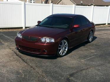

GEN 1 Sport only, using the OEM brackets and obtaining the Jaguar Rein #XR819697 30mm bushings from FCparts

The well lubricated narrower poly bushings and new link ends made a noticeable sharpening of the response from the steering input and reduced the lean somewhat as well, but that is to be expected compared to roached OEM rubber bushing and most likely warn OEM link ends. The new parts are allowing the sway bar to properly do its job.
BTW, I have use this split collar trick before on a couple other cars that had upgraded sway bars without the welded-on washers/flanges that limit side to side motion. It works every time. Based on the shape/curvature of the sway bar or other clearance issues, you may have to position the split collars on either the inside or outside of the mount bushings. Which every way fits will work, just remember that you have to do it the same way on both sides to properly restrain the side to side movement of the sway bar.
