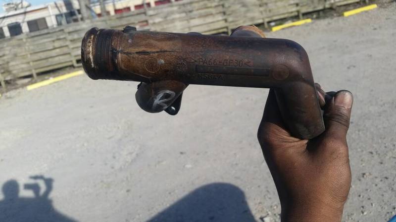

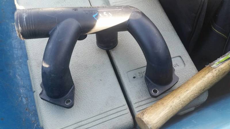

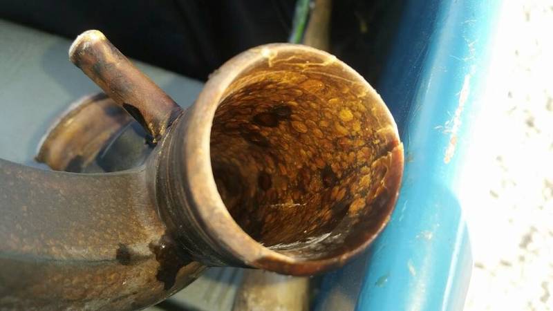

I swapped out my Coolant Outlet Tube with a junkyard one. Had a hairline crack.
However my temp keeps spiking.... I need new coolant. I probably diluted mine too much from overheating.
I swapped out my Coolant Outlet Tube with a junkyard one. ...
Bad idea. They all fail with time,temperature, and coolant exposure. Your junkyard tube probably has micro cracks in it that are letting air in. Your thermostat housing and degas bottle have the same problem. You need to replace the plastic parts with new ones, all of them. you also must follow the factory bleed procedure exactly. http://www.lincolnvscadillac.com/tech/drain-lincoln-ls-cooling-system/
Well its too late for all of that. I don't have the finances for all of that new. However when I do I'll replace it again. I'll just bleed and refill for now.

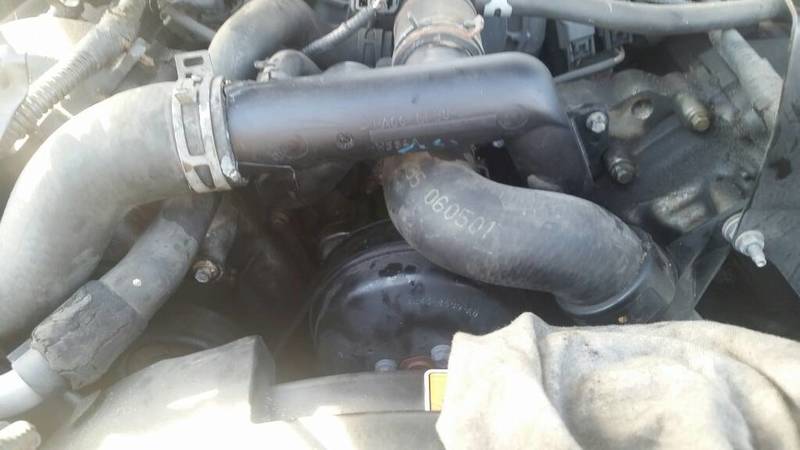

The junkyard one does look to be in better condition than what you had. But, all those parts fail at about the same time. If you're still overheating it's likely other parts are also bad. Pull the cowl cover around the degas bottle and examine it. It will most likely have many cracks. A third place, at least on mine, that was a major problem is the thermostat housing. They are made of plastic, but the thermostat depends upon it to keep the spring in place. Therefore, the housing is always under tension from the thermostat. It's not like other cars where the thermostat is fully self-contained. One of the ears on mine was cracked and the thermostat was cocked sideways.
I actually over looked everything else near the Tube and nothing looked out of place. The reason I know that was my only problem was because it was leaking. The leak landed on a hose below and created a puddle on the block. After changing it, there's no more leaking from it at all... However, I may go back after bleed and refill to buy those spare parts.
Yep. A lot of people post this. Maybe you will be the first one where it is true? Just because you don't see liquid, doesn't mean it isn't leaking. The micro cracks let air in before they let coolant out. Once the coolant does start coming out, often the only sign is a white (sometimes other colors) stain/residue that you may see here and there. By the time that you can see liquid, it is really bad.

Replaced my coolant outlet tube so no more dribble dribble. Yee haw!
