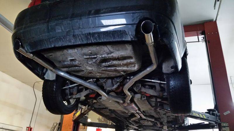

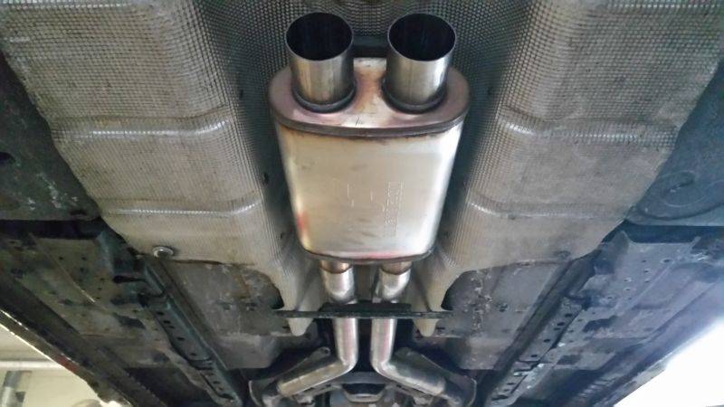

Yeah I send some links to a few select others.
1 single Magnaflow # 11386 - 4" x 9" x 14" Dual In/Out Satin Stainless 2.5" True X core design,
positioned in the tunnel, third CAT and resonators deleted, 2.5" piping w/ chrome Magnaflow tips.

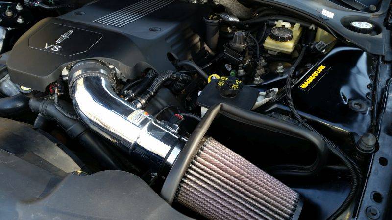

Forgot to mention the K&N intake was added to open it up a bit more.
It made a noticeable difference in the sound. Exhaust has also had a month to settle in.

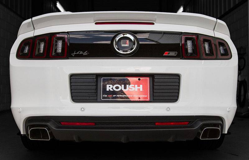

I went to class late because I accidentally started bidding on exhaust tips (who ends a bid at xx:15??). I probably should have let me decide on a price limit before my emotions and adrenaline got in, but I did "save" about $50. I thought they'd look nice with the LS' boxy shape
Hmm. NickT/NYCLSC used the 11379 and said it was a little too loud for cops. That one is a 4x9x11 dual/dual with a straight through design. He later added small bullet mufflers. I'm kinda decided I want to keep the stock resonators. But I did forgot how much I liked the 11379...

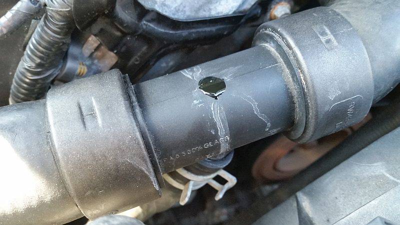

Last night I took notice of this on the 04 LSE ... Hahaha ... the fun I tell ya, it just never stops!
Remember last week I said not to put the tools away just yet, if it's not OK it's not the end just yet!
No worries, imma loosen the degas bottle cap, that'll fix it!
Nahhh! OEM parts from a salvage yard should last another 100k mi, I'm sure of it.
:: Hello Fordparts.com!?!? [Open Wallet]
ps: Soul, I did not sample this automotive fluid but I bet it's sweet! :p
Funny, that's the EXACT same place mine started leaking before I replaced the cooling system. My degas bottle looked exactly like one you posted a shot of a year or two ago. The cracks were almost identical even, to the point that I was wondering if you'd stolen a picture of my degas bottle even though I'd never posted pictures of it. My thermostat housing had an ear broken too, and the thermostat was cocked sideways in the housing. Lucky for me, it wasn't out far enough for it to jam but I can't imagine it would have gone much longer.

Yeah,you guys sure do put the pressure on those systems......LOL! I'm not a bit surprised you're bursting them right and left. :)^)

.... really dont want to get the jack back out tomorrow, was the pipe in front of the third cat 2.5 or was it 2.25(its been a little while, but I though I remembered the piping toward the rear ....
Everything is 2.25 from CAT back. Just have them cut it and spread piping to 2.5 and fit it to muffler then continue onwards with 2.5 out the back. People say u don't need 2.5 on this motor but I'm sure it adds to the sound.
ok, great thats what I figured. plus most of the tips I've been looking at all come in 2.5"

Increasing the piping to 2.5 will move the RPM band up a bit. 2.25 duals is plenty for a 3.9L though. It's the same size I plan to run on my 5.3L. Right now it has a single 3 inch, which is about the same as dual 2.25s. 2.5 inch tips can be put into a 2.25 inch pipe. They can put an expander into the end of the pipe and open it up a bit so it will fit the inside of the tip.

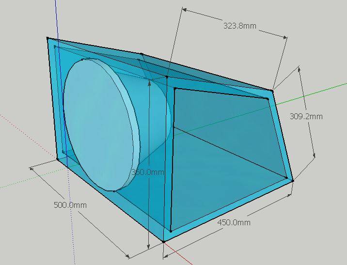

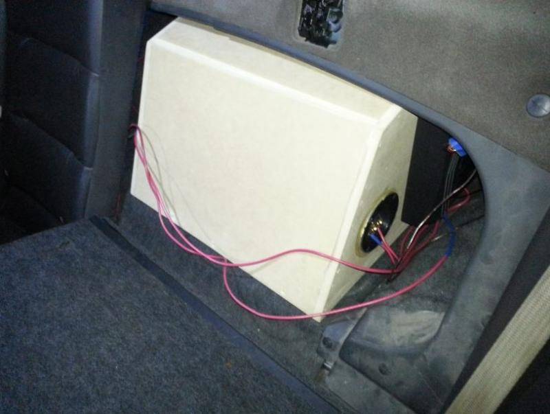

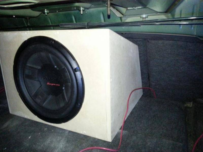

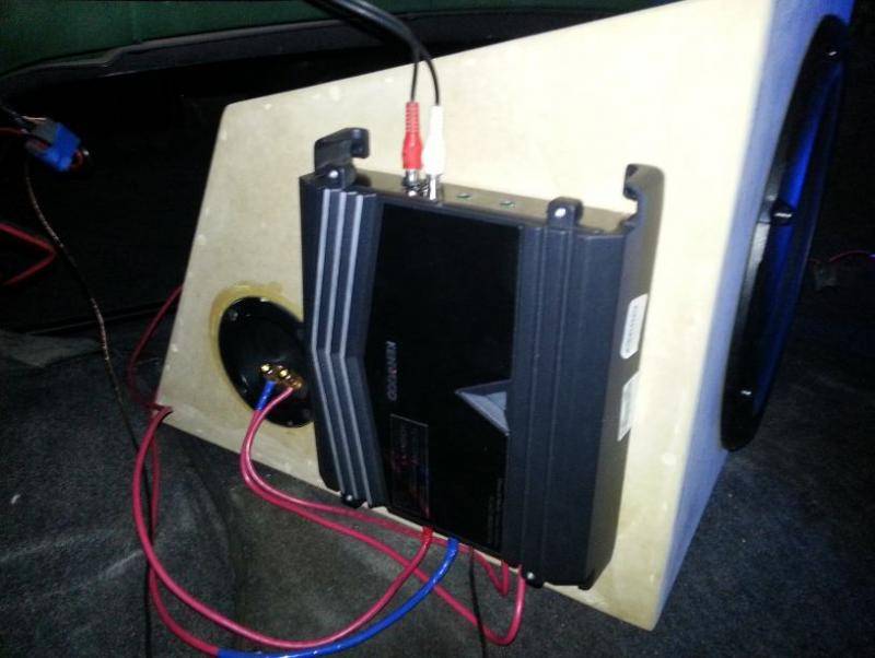

Hi!
I installed the new sealed subwoofer box.
wedge box, behing left back seat.
The subwoofer does not obstruct the spare tire access.
*Carpeting for later ;)
subwoofer pioneer ts-w311d4 400W@2ohms
kenwood kac-5001ps
Best regards!

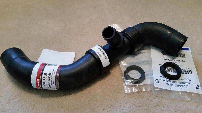

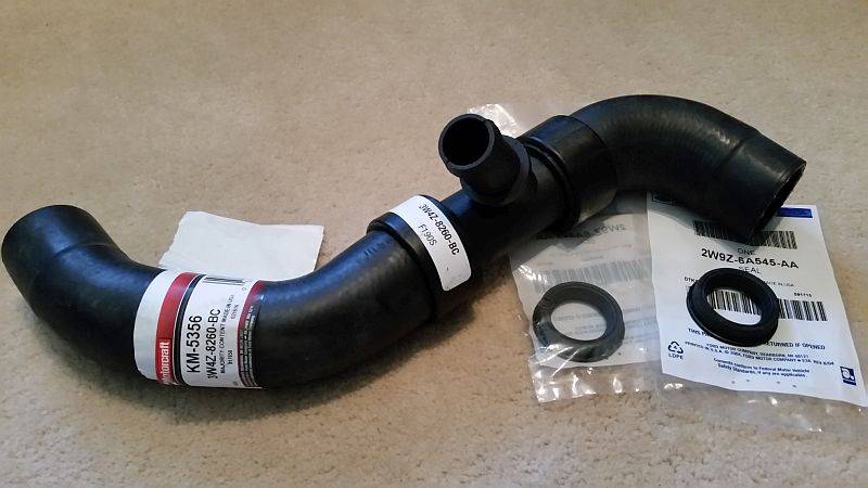

Ran to the post office and back for some parts. Best time to date.
R&R pending next week.
