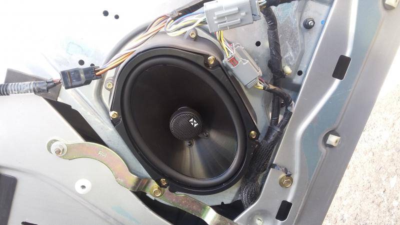

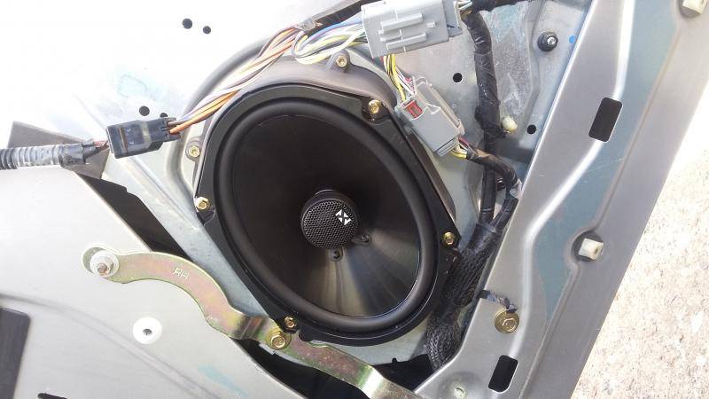

dealing with the speakers, are there wires involved such as stripping /cutting/crimping or are they just like the regular electrical connectors on the car?
The factory speakers connect to a harness. You can order harness adapters to make new speakers a simple plug and play install.

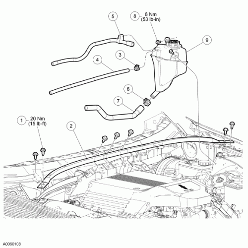

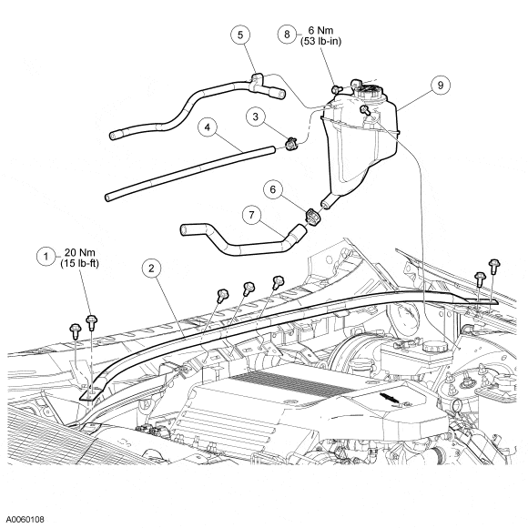

Start soaking those seven Cross vehicle support bolts (item#1 qty7) with penetrating fluid now ...
for when you go to replace your degas bottle ... they like to snap clean off.
... Don't take my word for it though! You can choose to find out the hard way also of course.

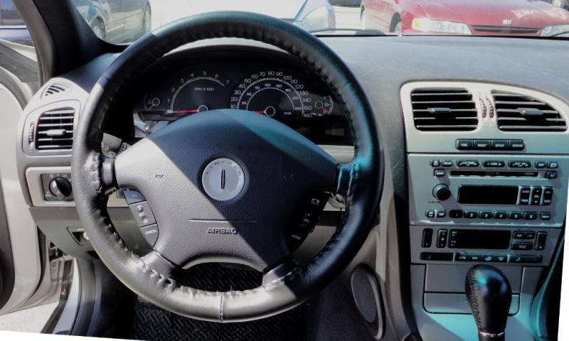

I have never really liked the factory Sport steering wheel. The leather covering is in near perfect shape, but the rim diameter is a bit too small and the factory leather is a bit too slick for my taste. Short of replacing the factory LS Sport steering wheel with say the FRPP #FR500 Mustang steering wheel with the embossed running stallion, I order a WheelSkin single color black leather wrap in the AXX size. I have installed these on four other cars in the past so the installation was straight forward and fairly easy. The results are a much improved feel and better grip.

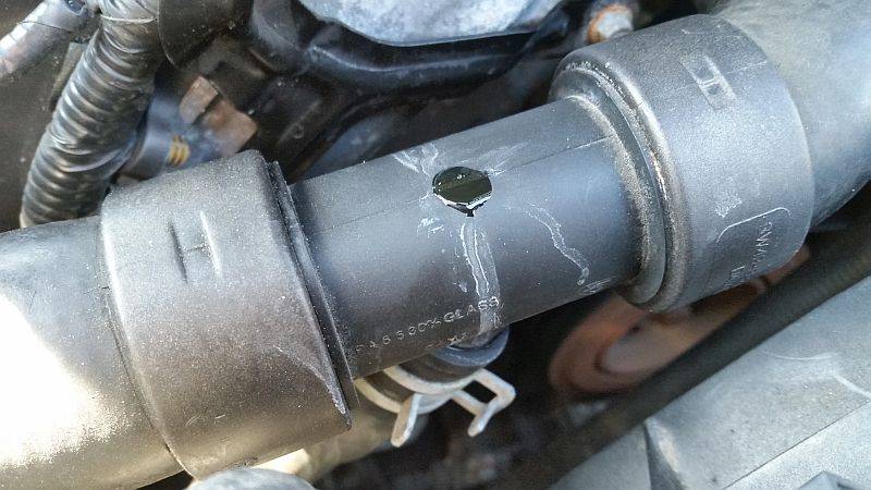

Last night I took notice of this on the 04 LSE ... Hahaha ... the fun I tell ya, it just never stops!
Remember last week I said not to put the tools away just yet, if it's not OK it's not the end just yet!
No worries, imma loosen the degas bottle cap, that'll fix it!
Nahhh! OEM parts from a salvage yard should last another 100k mi, I'm sure of it.
:: Hello Fordparts.com!?!? [Open Wallet]
Pretty nice for a cover. I don't think I'd buy one for fun at $70 shipped, but definitely an option if my wheel starts getting worn out. I wonder how close their Charcoal matches my [probably] faded cahrcoal interior
