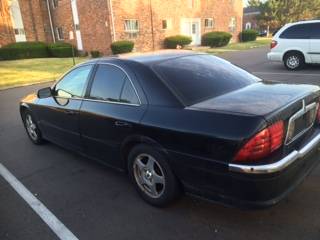

New clockspring and door handle made it so I was really loving this car. But then it developed a knocking noise in the engine. I have spent a couple hours trying to diagnose it but am not there yet. I even bought a new compression tester since my other two could not reach into the spark plug bore; not so much reach, but get passed the small counterbore in the head before the threads start.
Was hoping to install the new DCCV, but I guess that isn't a priority now.

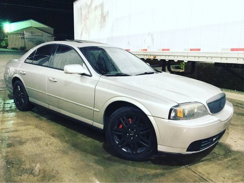

Bought new tires. Brought em back 2 days later. After two tries at balancing the tires, I still had a shimmy and steering wheel shake that I never had before. Tire shop blamed it on the aftermarket OZ wheels on the car. 'We always have trouble with aftermarket wheels' they said. Is that anyone's experience here? Cause an awful lot of aftermarkets are sold and they cant all be shimiying. Yes, they had center rings of the right size.
a lot of people have found the only way they get rid of a little vibration was to have the tires/wheels road forced balance.
When I customized my 84 Ranger and ran 35" wranglers I ran in to that from time to time. What it boils down to in my experience is 1) experience of the tech and/or quality of his machine is low 2) the rim is bent out of position so much that it cant be brought back in to balance.
Custom wheel and tire shops will have the tools and experience to analyze the rim itself, and leave that out of the equation.
After I switched to the Jaguar rims a few weeks back I had a noticeable front end shimmy problem at about 75 MPH. I had the rims spun ahead of time to make sure they were true and straight so I thought this was very strange. I took the car back to the shop and it turned out that on one of the fronts, they had accidentally mounted the high side of one of the tires on the high side of that rim. They marked the wheel and tire, then dismounted that tire, spun it 180 degrees in relationship to the rim, then remounted the tire and balanced the assembly. No more shimmy.

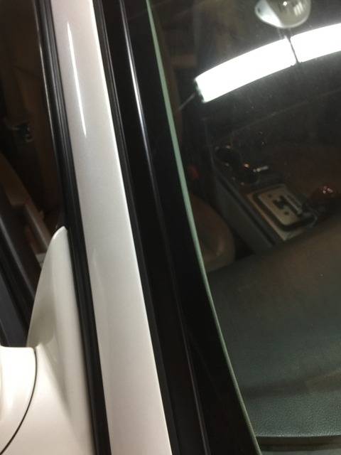

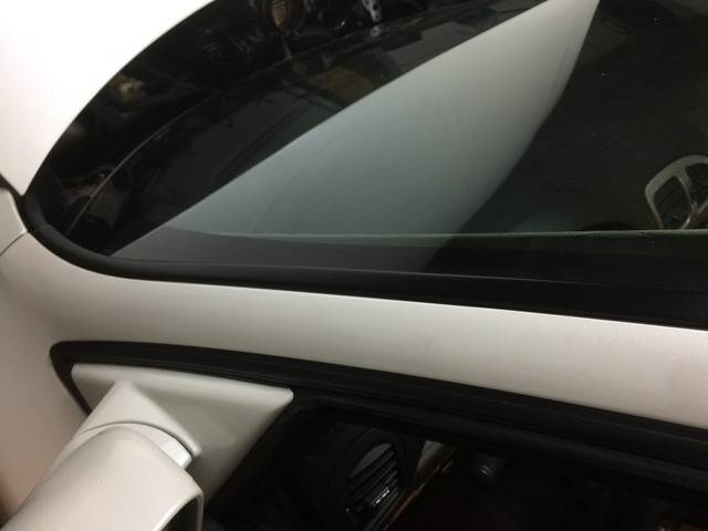

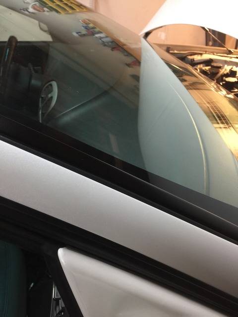

When I was out in the garage tonight I noticed the plastic strips that go up either side of the windshield just unscrew. Those were also very gray as well, vs black like they should be. Cleaned them off, and shot them with a few coats of satin black, its night and day!
Before
After
Drivers side
Not the greatest pics, but i'm working with very limited space in the garage at the moment.
