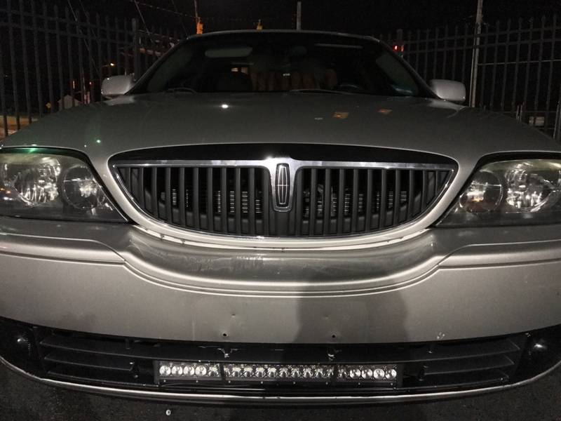

Touched up the faded gray grill with matte black to match lower bumper & wheels
Sent from my iPhone using Tapatalk
How did you get your grill separated like that, Patrick? Might be a dumb question. I had mine off recently to paint the faded gray just like yours, but thought I had to tape off all the chrome. I didn't see a way that it would separate, though it wasn't my main project so I probably overlooked it.
Yeah I just pulled mine off I see no way to separate those pieces. I'm mad now because yours looks so good with that simple "refresh" paint job. The faded gray really diminishes the front end of the car.
Can be done... There's a thread here somewhere...
It was actually quite complicated, including breaking the plastic weld on the opposite side of the emblem and unscrewing the 4 threaded bolts at the top on the backside. I should have taken pictures as I went along but it was too frustrating as it was. Totally worth it though.

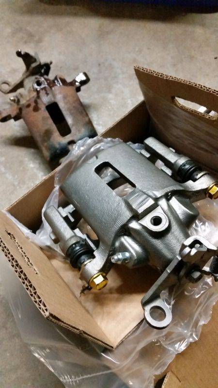

Changed out both rear calipers and right rear Lower Control Arm on my 04 LSE last night.
