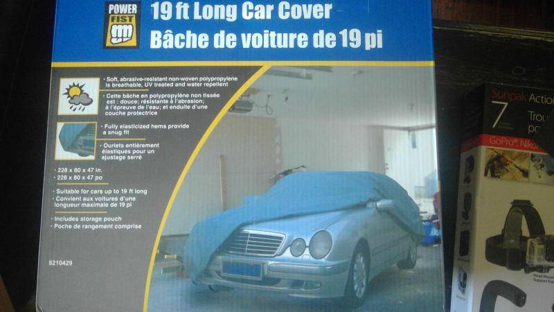

Didn't do anything on the LS but got a nice car cover for it from my mom for christmas lol. Pretty stoked cuz i got a camo tarp wrapped around her to save her from the rain and snow lol... WIN_20161225_09_18_37_Pro.jpg

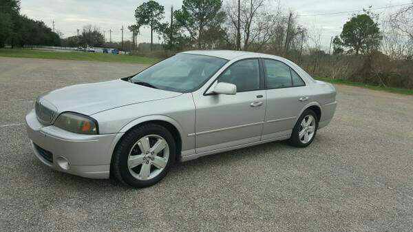

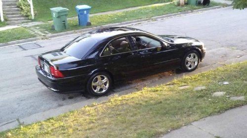

Finally bought my first LS! Been researching and reading this forum for over six months since deciding that the LS was the perfect platform to build a mild sleeper with my 15 y/o son. Bought a 2006 with <100k miles from a guy who really needed to pay rent and got it for $2000 as opposed to his asking price of $3500. Car is in mint condition and drives great. Driving it on the way home, I was going through the parts list in my head to do the full cooling system rebuild (per this forum) when you guessed it, she started overheating (I knew better than to romp on it that hard getting on the freeway before getting her home and checking her over). Needless to say I didn't want to do any damage, so I called a tow truck to have her brought back home. Ordered all the parts I needed today and should have them here by the weekend. Thanks to all of the regulars who have posted very informative and insightful posts that have helped educate me and build a good solid plan and budget for the build!

^^^ wow, sweet deal!

Welcome to LVC Cypress, sweet LS you scored there. Bit of fixing and she'll be a nice ride. Add a tune and she might be a little sleeper but somewhat limited. Either or ... great fun

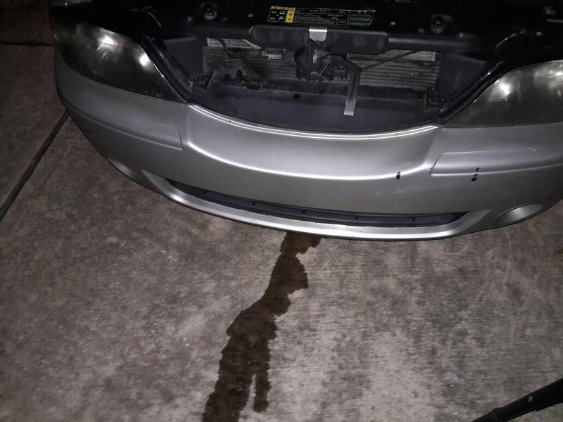

I watched my shiny new LS pee on the driveway! So I have all the parts coming for the cooling system overhaul, but I decided just to do a quick system fill/bleed to see what would happen. Two gallons of 50/50 later and the engine just starting to warm up and I see this. Guess I'll just have to wait until this weekend.

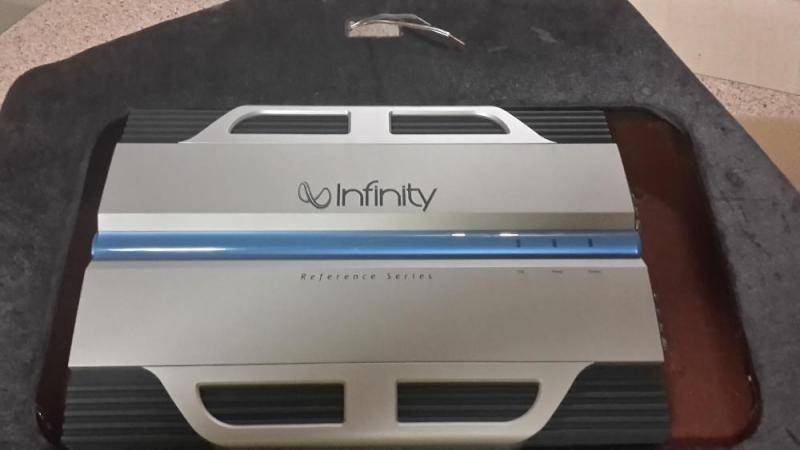

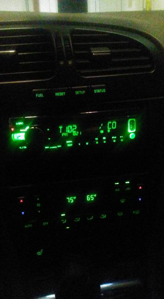

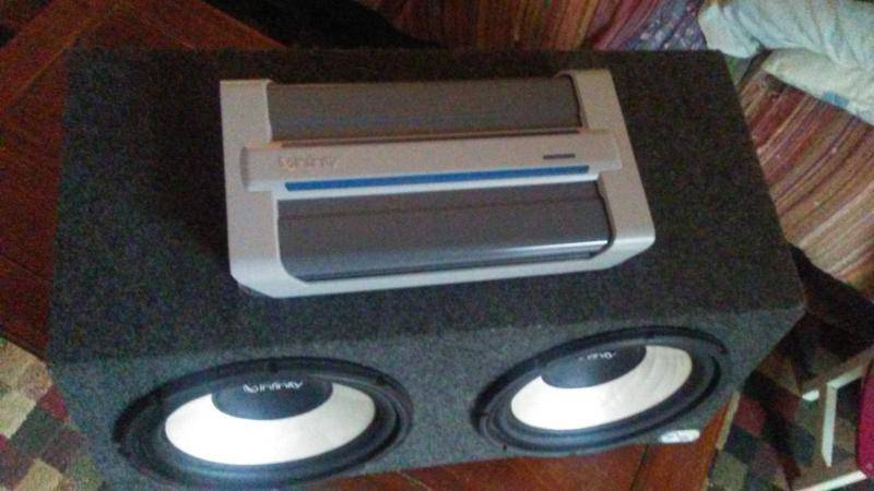

I installed a new Kenwood head unit and 2 Infinity Kappa 12s. I'm using a 611A monoblock for the subs and a 1500W amp for 2 sets of 5 1/2" component speakers in the doors of my 2002 LS. All the speakers and amps are Infinity and I'm pretty happy with how good it sounds. The Mids and highs are awesome and seem like they can take all the power they can get. I decided to go all Infinity after listening to my buddy's system in his Durango, that setup is all Infinity and will rattle your fillings loose. Next up for the LS is some new exhaust, this car is way too quiet for me so the stock setup has to go.

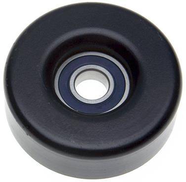

Replace the serpentine belt on my '04 V8 Sport yesterday - not the most fun job and scratched the hell out of the back of my fat hands. Found that a long heavy wire J-hook garden potted plant hanger to be an indispensable tool. Had to loosen the belt tensioner mounting bolt to get the old belt off and the new one on. I remember to re-tighten the tensioner's mounting bolt, but now she is making a few ticking sounds on a cold start-up. Maybe I should have replaced the serpentine belt tensioner as well?
Is is more of a snapping sound (loader than ticking). I found this video on youtube that captures the noise;
After doing some more digging and research on TSB 08-16-5.
Lincoln Workshop Manuals > LS V8-3.9L VIN A (2003) > Engine, Cooling and Exhaust > Engine > Drive Belts, Mounts, Brackets and Accessories > Idler Pulley > Component Information > Technical Service Bulletins > Customer Interest for Idler Pulley: > 08-16-5 > Aug > 08 > Engine - Drive Belt Snap Noise In Extreme Cold
I ordered both a new tensioner (just to be on the safe side) as well as a new idler pulley. The revised idler pulley design has ridges on side to keep the belt aligned on the pulley, which solves the problem.
Sorry if I am rehashing an old issue.
Had the same issue/sound on cold start on my 04 LSE shortly after I took possession of it.
Resolved by replacing the tensioner also. Did belt and pulleys at the same time. Nice and smooth since.
