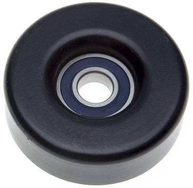

The revised idler pulley design has ridges on side to keep the belt aligned on the pulley, which solves the problem
Sorry if I am rehashing an old issue.
Dug into my 05's belt drive today after buying an idler pulley. FWIW for cheap impatient people like me: the Auto Zone pulley ($18) is not flanged but the Gates ($21) is, looks just like the revised Motorcraft design.
Went into the belt drive to address some chirp, my first time really getting under the hood. Replaced the tensioner (original at ~87K) and found out a rock stuck in the belt (!), one of those seems to have fixed it. Bought an idler pulley but decided to wait until the cooling system refresh to replace that, not a ton of room in there to work and I was glad just to get the tensioner and belt back on with only minor blood loss...
I ordered the Gates #36270 flanged idler pulley off RockAuto for $19.22 with shipping.

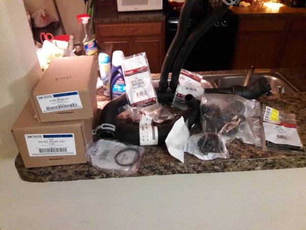

I'm always amazed that people can read through this forum and not heed the advice of others that have already been there! Genuine Ford parts arrived today from Tasca for the full cooling system overhaul on my new 06. I want to say thanks to all who contributed to the Gen II cooling system overhaul thread. The part numbers, advice and descriptions are a life-saver!
