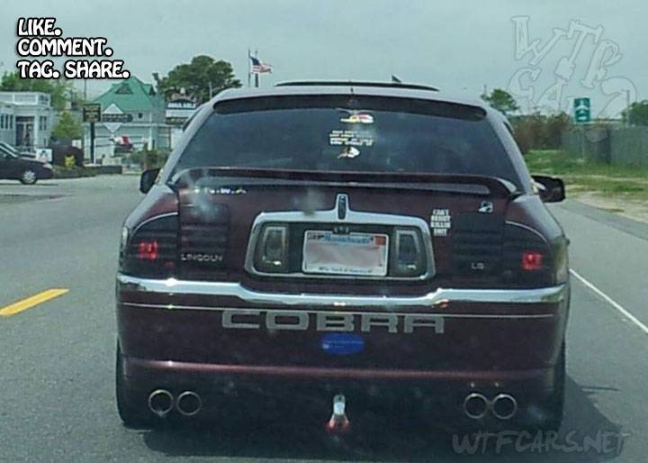

added some stickers to my LS
At least the tips look good....
I drove mine to work today, and admired how clean it still looked because I drove 5 MPH down the 1/4 mile gravel drive.
Why is the deck lid partially open?? Multiple bodies???

Looks like a recent pic due to the new rear glass spoiler, why were you not able to put the rear plate back on evenly.
The trunk is ajar most likely cuz your sub box it too tall?
