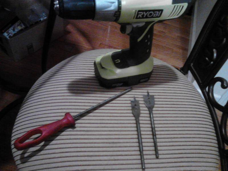

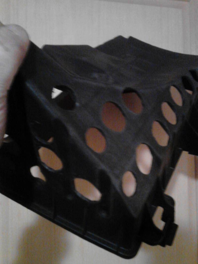

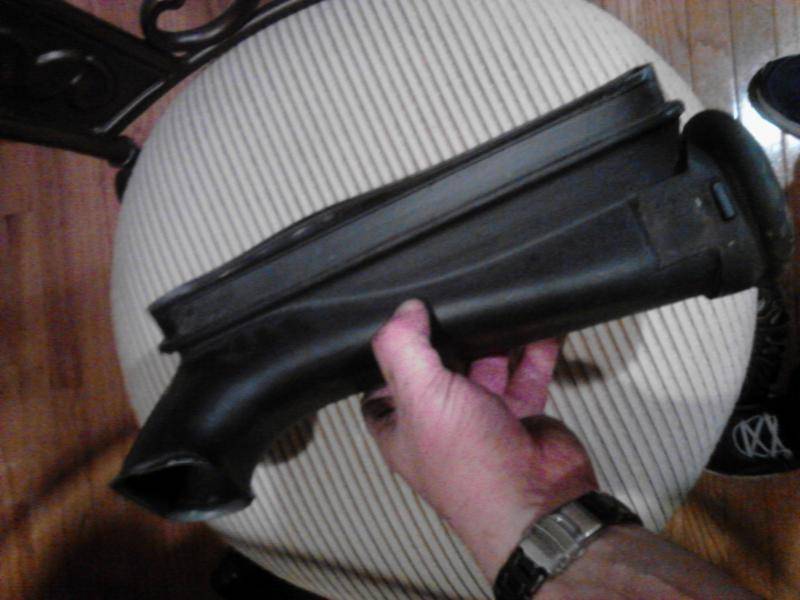

Last night, I did the poor man's intake mod. I removed the air box, looked at where the stock filter seats to and began drilling out below that level on the two closed sides. Also removed that air-horn-looking thing that is really pretty nifty, but probably restrictive. I unhooked the battery for 40 minutes while I drilled the air box.
After I hooked up the battery, I went to open the driver's door and that set off the alarm. On startup, I got an error about 'foot on brake/set parking brake. That finally went away after a few minutes of driving. The memory seats would not accept a setting until this afternoon. Now, everything seems normal again.
Car is scary fast now. Many say that you only get better throttle response or you don't really get HP gains. I dunno. I think more air in makes a huge difference. I've certainly had vehicles (F-150 V8, Regal V6) that didn't benefit so much from this mod. But those were one valve per cylinder engines. Four valves per cylinder can make much more use out of more air in. I didn't have the $270 to blow on the fancy aftermarket intake. My cost, $0.00! Total time, about an hour and a half (I'm slow as a turtle). The most time-consuming and annoying part of the job was filing off all the plastic from the edges of the holes I drilled.
Of course, now that I know I may have a bearing replacement ahead, I'm not going to be punching it much at all.
Removed this thingy:

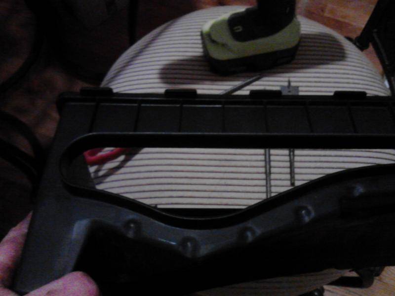

Making this opening less restrictive:
Tools used: drill, 1" and 3/4" router bits, round file
My new, swiss-cheesed airbox:

Looks pretty cool 2005LSV8! Might as well cut the whole bottom out though like on here: http://www.lincolnvscadillac.com/tech/Lincoln-LS/Modify-Airbox/
Nice, but I noted that the modder both cut the entire bottom of the box off and complained about the airbox now being far more bendable. It looks like he cut the bottom out by cutting along the side of the box in line with the bottom. If you were to cut the actual bottom out instead, leaving a half inch lip on the bottom, around the curve from the side to the bottom, you would retain the most of the stock rigidness of the box and would still get the benefit of the opened box.
Really, if this is true then Ford will save a lot of money by getting rid of the snorkel and since there is less material for the intake housing it will be cheaper (either making more holes or cutting the bottom) to manufacture. I hope this is not just a placebo effect. There might be a difference if the air filter is dirty to begin with and was replaced with this mod.
