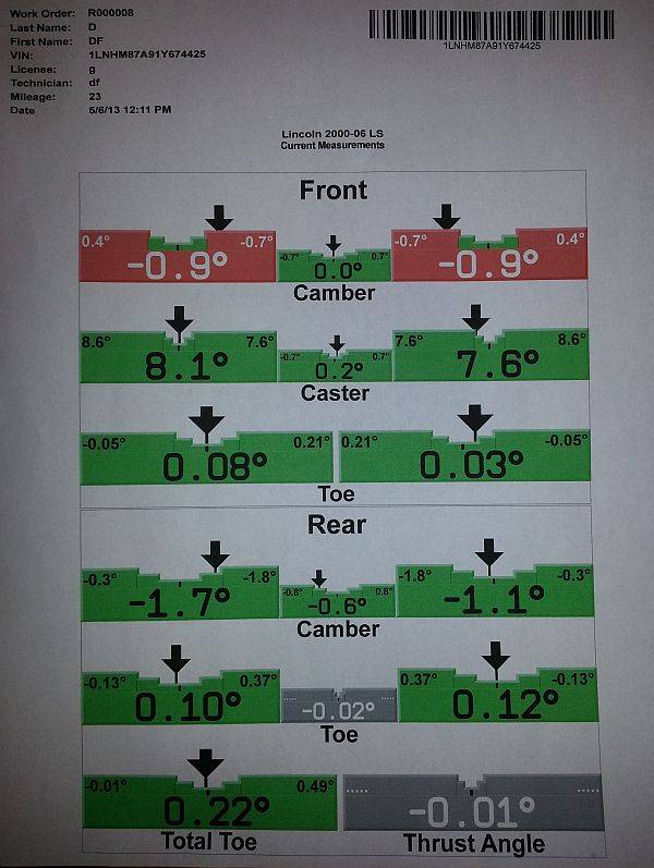

Had my 4 wheel alignment done today after the front Eibach Springs had a chance to settle.
Anyone able to tell me if these numbers look about right ?
I'll try again, anyone able to tell me if the above numbers look ok ? within 1 degree should be fine ?
is that all the adjustment they could get out of the front? if so, that is probably as good as it gets with doing something to get more adjustably.
Does it not look right to you Chris?
They said it was within Spec for this car. I myself was concerned that the Camber is listed in red but then read online that as long as it's within one degree.
Really don't want to start wearing out the new tires unevenly.
no, this looks real similar to other LS's with Eibach springs.
eibach sells an alignment kit for the front that is supposed to help with that front alignment though.
might be worth looking into, i'm not sure how it works. eccentric washers i think.
thanks Chris, I had understood that it would be real close to get this set up right and that it would even take two men to do so.
If it's within spec I'll keep an eye on the tire wear. Thanks again!
That looks good. You're less than 1º negative on the camber, which is acceptable. Just be sure to rotate your tires every 5K miles or so. Mine's been like that for a while now with tire wear not unexpected.
The Eibach (or any other similar kit) consists of concentric bolts.

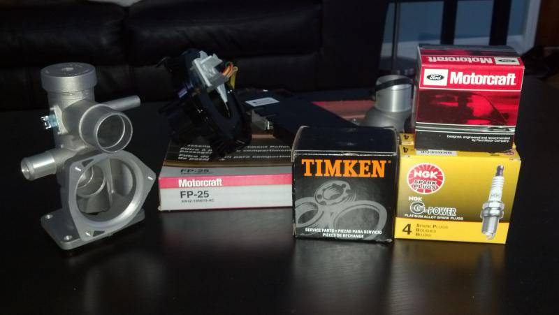

Big day planned. Jag tower with motorcraft thermostat, clockspring, cabin filter, ngk plugs, and oil change. Rear wheel bearing later this week.
Nice +1 on the Jag Thermostat housing upgrade.
we got in to the thick of it on this page here: http://www.lincolnvscadillac.com/forum/showthread.php?88570
towards the bottom, there is plenty of info on upgrading to the Jaguar Thermostat Housing.
You are going to need that "special" wrench to get to the two back bolts. Telling you now, she's tight.
