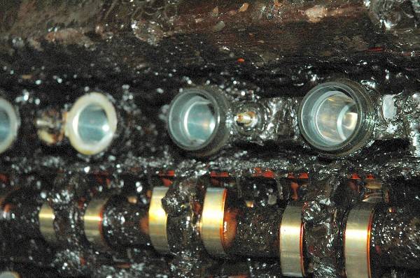

Now the picture shown is actually an engine that was on a 15,000 mile oil change interval according to the info quip on the picture, but super short drive intervals will do the same thing.

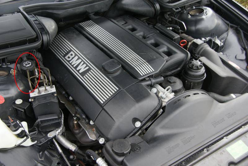

I quoted your picture because that looks horrible and I was going to comment on it. Then, in the post edit, it showed me the link was from a BMW forum....Hope that guy is wealthy.
Yeah, I just grabbed a picture of a generic gunked up head. One of my dad's neighbors had a 90s 3 series that wore some cam lobes, and was quoted something like 2200 bucks just for the cams. Not everything you need to replace them, just the cams.
The problem is that BMW has 15K oil change intervals. They require LL01 oil at 5W30 to 0W40 to achieve this. A lot of people never read the LL01 part and just put any 5W30 oil in and this is what happens. (The LL01 is a little hard to find in the US, apart from Mobil 1 0W40 European formula.) I had to change the valve cover gasket on mine at about a 150K, and it looked pretty good inside, but then its always gotten the correct oil.

We are talking about an E46 BMW, and your picture looks like an LS.
I promise you that the M54 engine in my 325i does not have a fill tube.
http://upload.wikimedia.org/wikipedia/commons/3/3b/BMW_M54B25_002.jpg
Ok, that is my bad then. I thought since this is an LS thread, there was still at least one thread connecting to the LS. I thought the BMW pic was just used for illustration purposes since we all know that any LS would have completely disintegrated before it got half that bad. I also thought the original mini discussion included a V6 and an '06 which I may have mistakenly linked to LSes associated with Godz-Soldier.

Ok, this is where I started following the topic of the V6 and the '06 LS. The BMW pic was used as an illustration for a sub-topic of the 15000mi oils and those trying to use non euro spec oil for these long change intervals and ending up with that type of result.

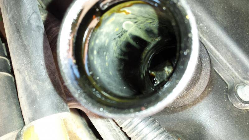

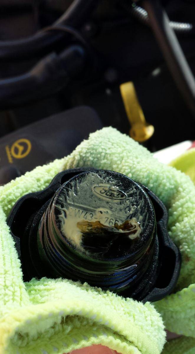

Also what is the acceptable amount of foam under the cap??
I'd start rinsing that out, doesn't look healthy at all.
There are detergent available you add and run for a bit prior to oil changes.

Dip stick is clean. I guess this is normal if you take short trips/sit for long periods of time which is what my car does.
