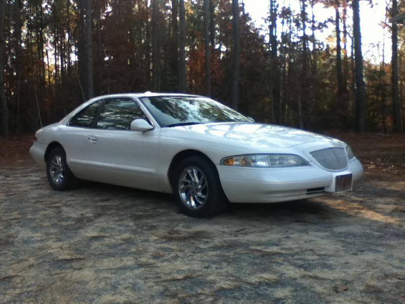

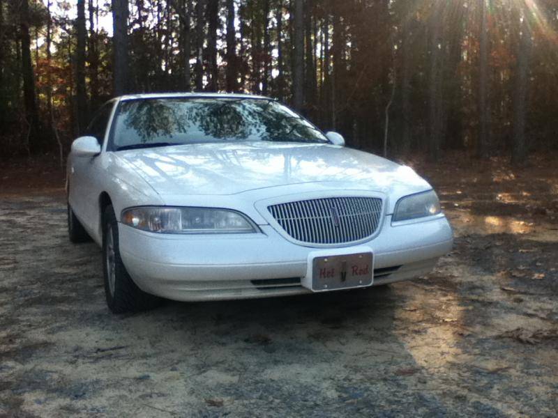

just finished wiring the hid bulbs9006 8k in the headlights testing to see if the ballast work properly.... what u think
Havn't done anything as of late. I can't say she likes the cold weather though, but she's getting through it fine thus far. Just not looking forward to finding out how she handles in the snow. If she let's loose when I feather the throttle in the rain it'll be a LONG winter if we get as much snow as they say we will.
just finished wiring the hid bulbs9006 8k in the headlights testing to see if the ballast work properly.... whsat u think
That looks pretty:) I'd like to see a more "focused" pic though.
