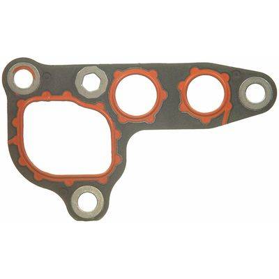

Last few days I've noticed a faint oil-burning smell inside the car. I look underneath and see some oil on the driver side catalytic converter shell but not sure where it's coming from??
I think the oil pressure sending unit may have been the source of my oil leak:) After installing the new one, I smelled oil yesterday for a while, but I haven't smelled any this morning. I'm hoping that it was just burning off what had leaked out prior to installing the new one. Crosses fingers...
Heard you should wrap some teflon tape around the threads when replaceing said unit.. Not sure if you did that or not.
FWIW, a famous oil leak for ANY 4.6L engine is around that oil adapter gasket; I've changed dozens at the shop. They are under $10 at any parts store (Fel-Pro 70415) and look like this:
As a matter of fact, I've got two of these at the house! lol
