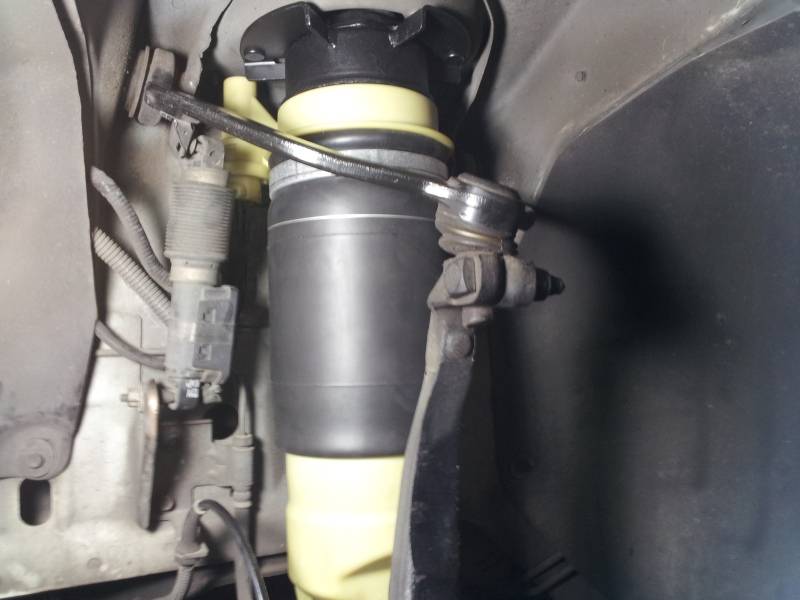

Well, got home tonight, aloud banging noise has been bothering me for over a year, finally decided to investigate the issue, turns out the air SHOCK was damaged. I'm not sure why, they were only 2 years old and the noise showed up a year aster they were installed, I thought it was the cheap upper control arm. They didn't have moog instock, so I bought the duralast brand. So upon inspecting the car for the noise, found the ball joint boot ripped, thought maybe the joint was bad, picked up a new upper. Still had warranty on rotors, they were warped so it has new discs. Replaced upper, and right front air SHOCK, the noise is all gone. Smooth ride and quiet. Since I have the drivers air SHOCK, and its been installed as long as the other one was, should I replace that one too? I was noticing a little rattle from the drivers side, should they be replaced in pairs?

Best if changed in pairs

Anyway I was looking at it this way, If the one was bad and the other still seems to be good should I keep it as a good known spare or swap it out and keep the one thats on there now as a ok spare...hell even the other one I took off held air, the bladder was good just noisy and a bit of wheel hop when you hit a bump. I guess would be good enough if the bag were to blow out.

Nope. Control arms would warrant an alignment, but new air shocks with no height sensor adjustment doesn't.
True. Unlike struts, the air shocks in a Mark VIII do not attach to the spindle and they have no effect on the alignment. Thank goodness our cars don't have struts in the front.;)
Yep. It's always a good idea to change your front air SHOCKS in pairs.:rolleyes:
That way you know you have two equally good SHOCKS. If you replace one and not the other, the ride/handling quality could suffer because of differing stiffness of the new vs. old SHOCKS.:D

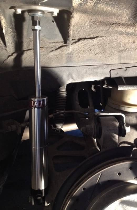

Pulled the tube out of my Bilstein last week upon acceleration, not sure what caused it exactly, but nothing is worn or loose under the car. All the bushings are good, bags are good.... chalking it up to a faulty part that I'm having warrantied.
In the mean time.... was steered towards these by a cobra buddy, got a set online and installed them last night. They have 18 adjustments from firm to soft. I've been playing with them today to see where I want to set them. Were almost to pretty out of the box to install.
Link to shock info
Wow! Those are nice! But I'd put some kind of sleeve over the shaft just to keep the dust and dirt off. 18 settings??!?! That's awesome. Too bad you can't put some kind of stepper motor or something on top of the shock and attach it to a rheostat or pot to make them adjustable from inside the car while you're driving. That would be serious coolness:)

Expensive, but very nice.
which model did you use TS706 rear 70-04 mustang?and are those delrin adapters at the top, you used those with the bilsteins as well correct?
