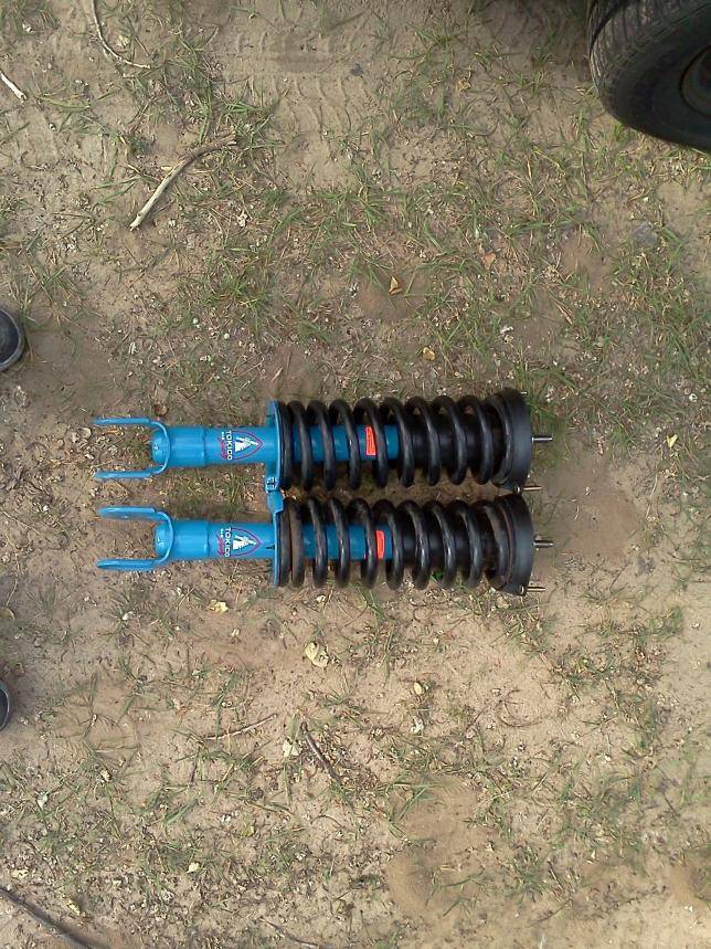

Just had my Cobra Bilsteins delivered today. I hate some things coming over the border as I get raped.
So here it is, I paid $65.00 for the pair of shocks, $42.07 on shipping USPS and then when I get them to my door the Canadian Border Customs nails me for another $30.00 in taxes. All because the guy shipping them wrote the declared value of $150.00 instead of the $65.00 I paid for them.
Install this weekend

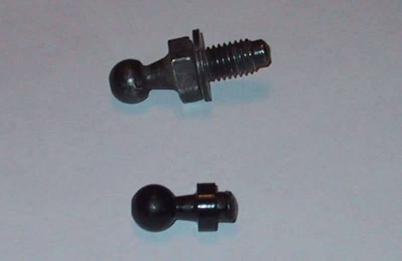

:mad::mad:cant beleive the sh!tty Luck this morning.. I had the car purring for 24 hours, now the stud that holds the height sensor inplace on MY BRAND NEW Upper Control ARM has snapped off while I was driving on the highway... Guess what happened next? yep airbags inflated to maximum capacity..:mad::mad:
It took me over an hour on the side of the road to play with the sensors both sides to get it to deflate. is there a more direct way of deflating the bags should this occur again in the future? I mean besides tearing out the solenoid and air line..
And Oh yea, Now have to replace that freaking upper control arm again 2 times in 2 days. not cool. Guess when I do that I'll replace the other air shock...:eek::eek:

Go to a junkyard and get the trunk lid lift ball stud off a SN-95 or later trunk lid. It is threaded into the trunk lid hinge so you will have to get a nut to fit it (not sure of the size), and you will have to drill the hole in the upper control arm a little bigger, but it is the same size as the original ball. I did this on my old '94 Mark VIII.
Here is a pic:
This will save you from having to replace the whole arm.
yes. i have full manual control in my car. requires some less than fun wiring.
read here:
http://www.markviii.org/LOD2/airsuspension2.htm
