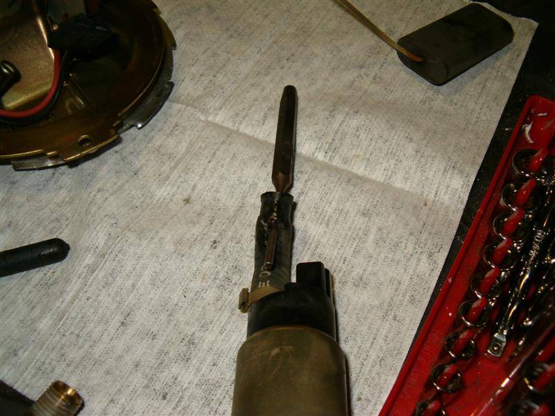

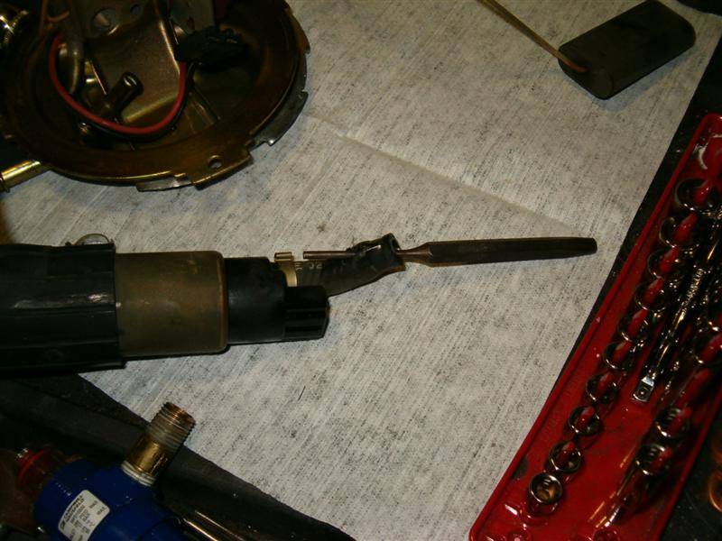

Finally fixed my fuel issue.
I finally fixed my fuel start problem. Went ahead and replaced the fuel pump last night. Found out it wasn't the fuel pump, but the transfer hose between the pump and hat/manifold. Here's a couple of pics.
