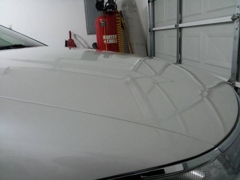

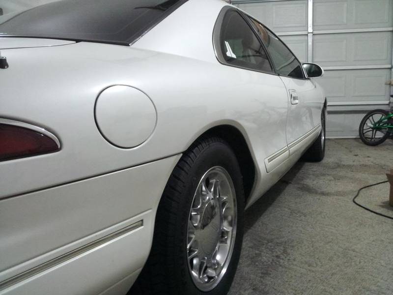

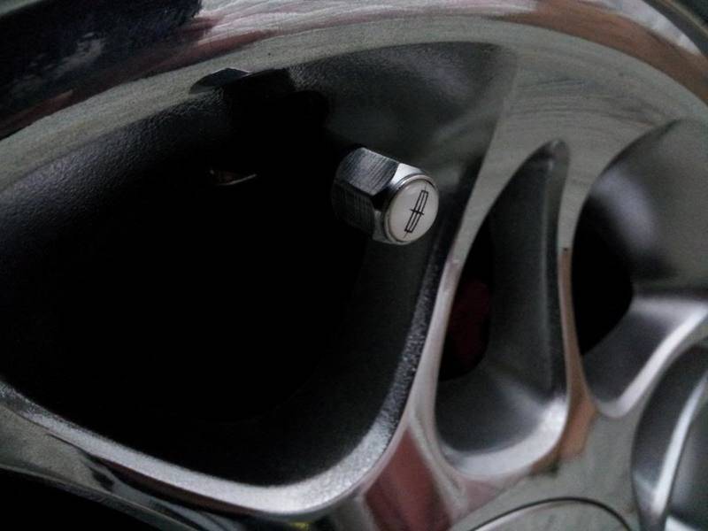

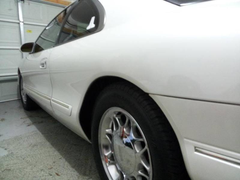

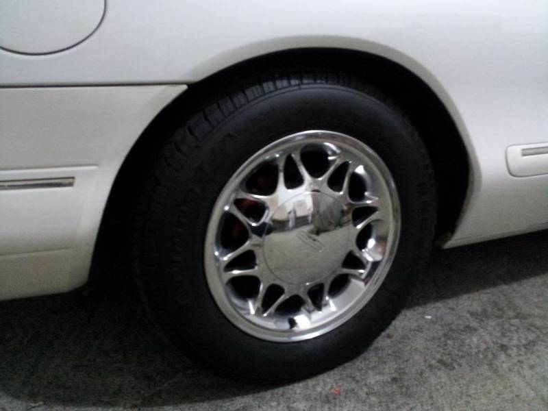

Annnd, I waxed my car early this morning a second time because it was cool in the garage and the wheels and tires are sparkling.
Sorry for the blurry pics. Didn't realize they were like that till now.
