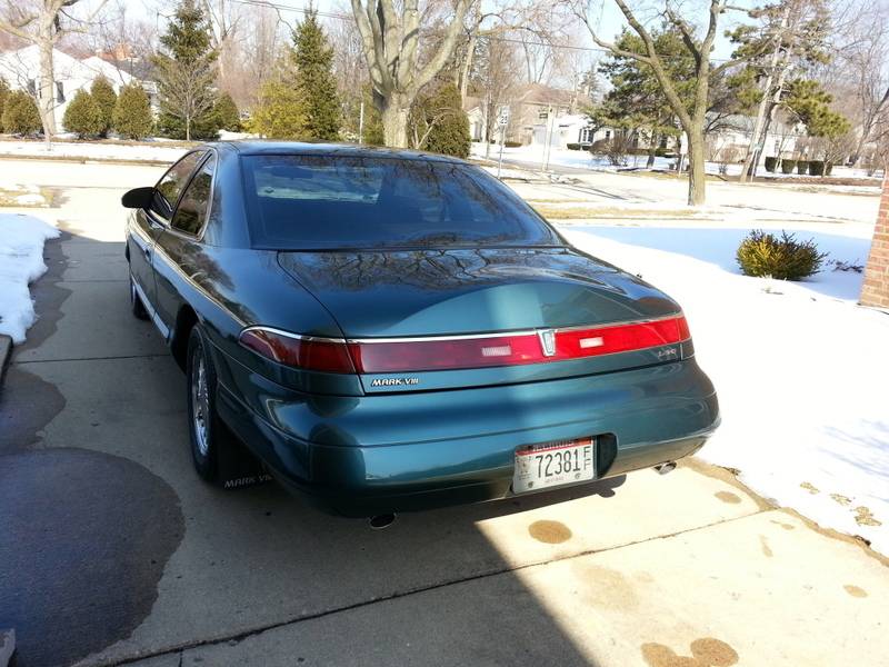

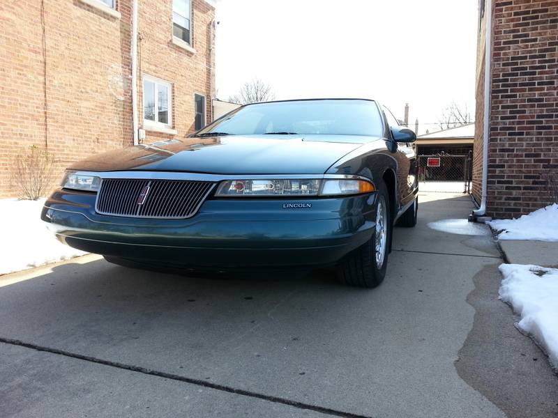

Finaly upgraded my old htc incredible to a galaxy s3..love the phone! Figured I had to test out the camera and take some pics of my car so might as well post em up, gotta love clean cars in the winter! I'm excited at the video quality too..should make for some cool videos when I go to the drag strip.
Looks great, too bad it's going to snow tomorrow. :p.
i know..thanks for reminding me..hate winter, hopefully I'll be at work before it starts, and it'll just sit all day and get snowed on and the streets will be cleaned up before I leave wednesday morning...but that's just hopeful thinking
