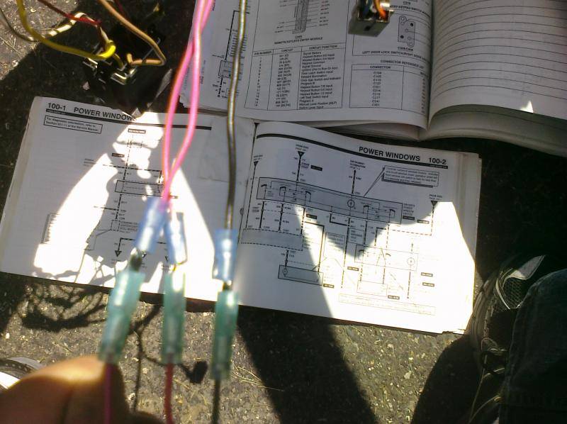

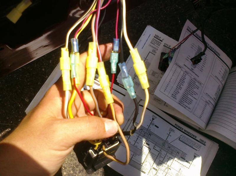

Figuring out all the connection, man this took a long time. The trunk wouldn't open at first because the wiring was different, that took a while to figure that out. Also had trouble with the lock and unlock button lights to come on. Memory worked straight out of the box though. Pic of preliminary setup.

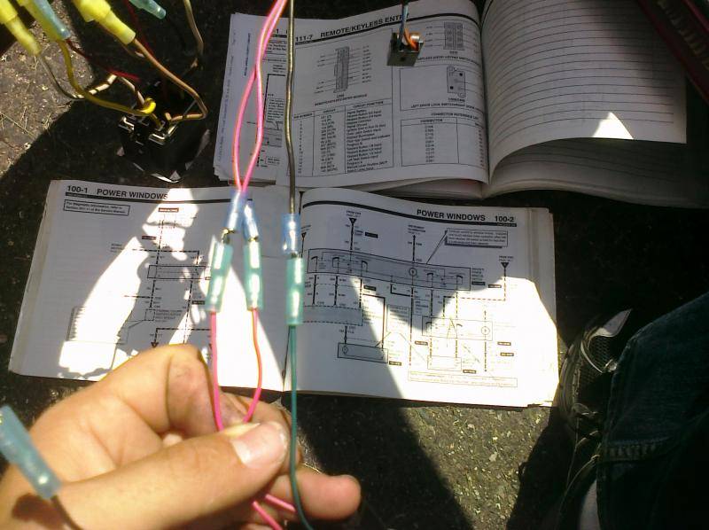

This is how I wired up mine. I know, not the best pictures but it is all I have for now.
Yeah I have all the locks and windows done (the pics of you posted). I am stuck at the power side mirrors. BTW did you get everything to light up because my wiring looks a little different.
@Sap Yeah, I looked at that thread but no where did it show the wiring for the power side view mirrors. I know GMAN said the color coding matches up, but that's not the case for the side view mirror. I have read the 93 is different, don't know how true that is.
