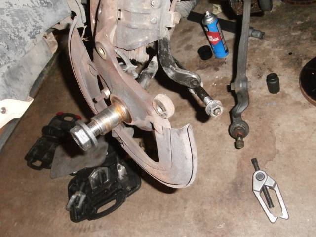

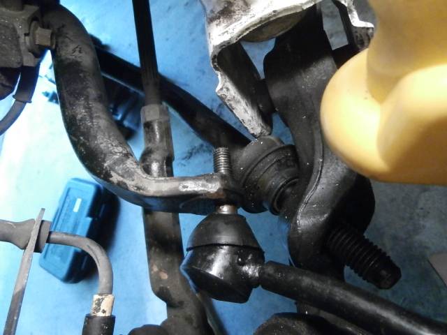

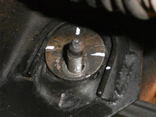

started dismantling front end suspension prepping to replace Hubs, LCA's, SRB's at LCA and sway bar links..running into difficulty:
1)getting the lower shaft from the sway bar link to back out of the stabilizer:
and
2)getting the camber bolt at LCA and subframe to back out
anybody got suggestions?
Since it was over 2 years ago now that I did my LCA's lets see if I remember correctly how I did it?
I do believe I had to spin the bolt out of the shock/air bag assembly. The Sway Bar links I did with a pickle fork ball joint tool. A small head U as my Ball Joint tool has 3 sizes to install on the unit.
The main bolt with the camber adjuster I think we put a nut on the end to make sure we didn't damage it and wailed on it with a hammer :confused:

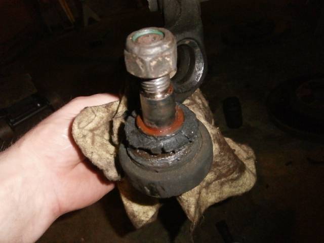

stepped off then came back and got something done, I thik I found part of my 'clunk'...(Lower BJ)
had to use the wobbly jaws/arm puller to get the stinkin' end link shaft out of the sway bar..no idea why that was so hard
how the heck does that ABS sensor come off the spindle? I loosened the 8mm bolt already
thought I could keep the outer tie rod ends, but they look pretty bad- gonna replace those also; do the inners also typically need r/r after 100k?

The reason the sway bar link was so hard to remove is because its a tapered fit just like a balljoint or a tie rod. And it looks like your cam washer in the pic is bad, it should be at 3 o'clock. The flat on the bolt should face the thickest part of the washer
yea, after smacking it around for waaay too long I put the arm puller on it and pressed it out
the cam washer did have the thickest part at 3'o clock before I turned it 90 deg....back at it today
