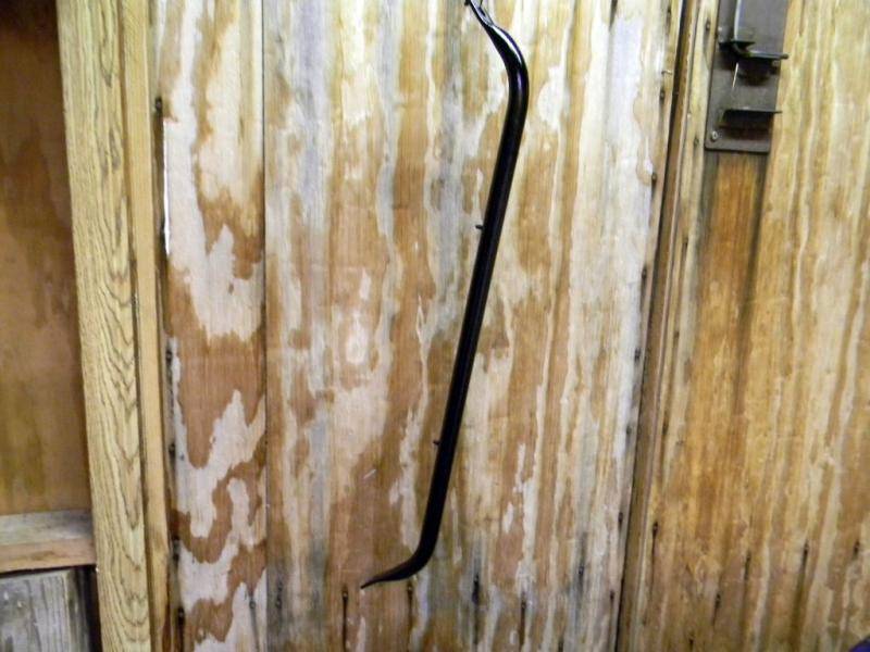

This brace is in front of the forward SRB's, had to remove it to gain access to the 30MM nut's (so I thought I would paint it), it has two stud's on the inside that go to nothing.
What is this brace for and what are the stud's for? It goes from the ds frame to the ps side frame?
It's a brace... for...bracing
Also makes a good handle for when you use your Engine Cradle for doing curls
