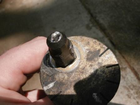

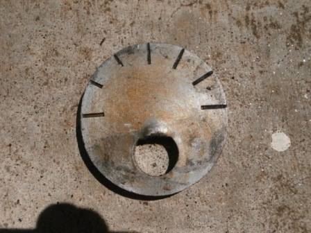

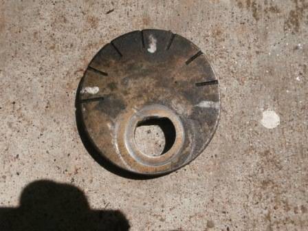

yea, after smacking it around for waaay too long I put the arm puller on it and pressed it out
the cam washer did have the thickest part at 3'o clock before I turned it 90 deg....back at it today
Yes but the fact you turned the washer shows the washer is junk. It should have a flat spot locking its position to the bolt

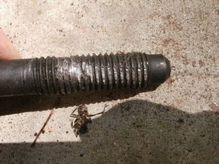

the washer on the nut side turned because(due to my lack of experience/ignorance) i turned the bolt from the other end...here's some photos, I think it's reusable, although the bolt has some of the threads flattened a bit, it still nuts up
yes, that is a dead piss ant on the crete
Buy new cam bolt's from Advanced auto. That's what i just did, they were better then ever and worked perfectly! $22 each, at least you know there new.
why should I buy new ones? there's NO rust on these; the other side came out easily (b/c I did it right)..this bolt is flattened on some of the threads, but I can't see it loosening...I'll take it by the alignment shop and see if he's okay using it...
That spot in the washer could cause the alignment to slip, I think I have a spare washer I can send you, PM my your addy and I will drop it in the mail this afternoon.

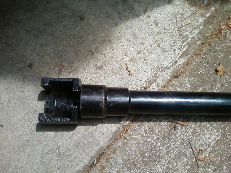

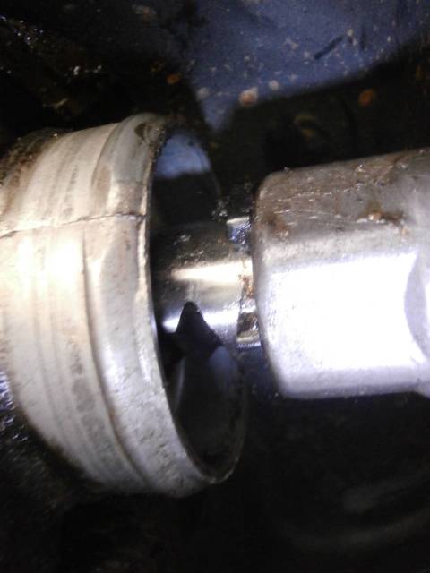

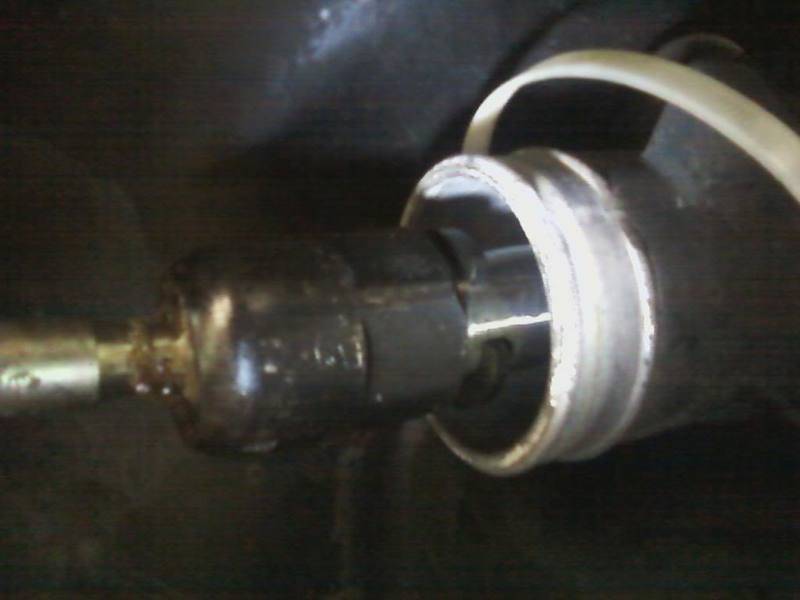

Removing inner Tie Rod ends- how to remove correctly?
(kind of a fuzzy pic_ cheap phone camera)
I thought there would be a very small locking pin to pull out before unscrewing the swivel nut?, but all I see is the black ring which is not firmly attached/secured to anything_this is the RH side and NOT the orig. inner tie rod end
1 5/16'' crows foot looks to be the right tool to remove
and on the LH side, the orig inner tie rod end...don't see a pin here either...
eh,update:
got my answer...apparently some swivel nuts will have a rivet or pin, some won't...i guess mine doesn't have a locking pin
