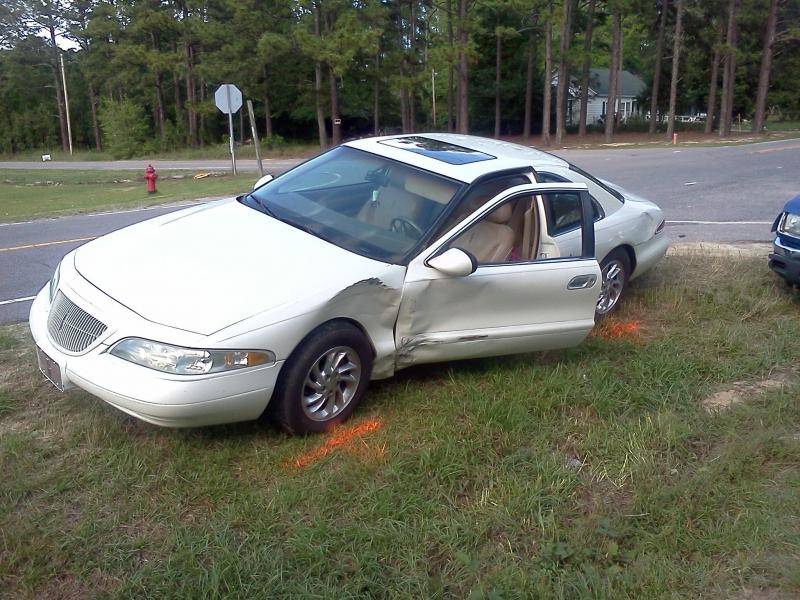

My Poor Mark VIII.jpg :( :mad: I almost cried when I saw it.

I'm thinking a new front fender and a new door will pretty much get it back on the road. The suspension doesn't seem to be damaged. However, there is apparently something wrong with the fuel system. It must have damaged a line or something because the wife said it had 1/2 a tank of gas in it when she wrecked but when we tried to start it, it wouldn't run and the gas gauge was sitting on E. Then we put a couple of gallons of gas in and it started up and ran. So it must have leaked all the gas out somewhere. But I think it won't be more than $1500 to fix it (hopefully). I'm just so beyond upset, frustrated and angry right now, there's just no way to describe it.

The intertia switch didn't "flip"? That's what I thought the problem was at first until you stated that it started once you put a couple gallons in. I've had the intertia switch trip from a 2l bottle of soda in the trunk on a light right turn.
If it would cost 1500 to get it into shape I'd just pitch it or buy it back very very cheaply if you think there's money somewhere in it. I sure hope it would've triggered in this case.
My heart sank when I saw the picture. :( I definitely would have cried and probably wouldn't have cared whose fault it was. Glad she wasn't hurt, but I'd have been pretty violent about it. :Bang :mad: argue2 Pics like this really break my heart. I don't even like looking for parts on wrecked cars.
Now that I look at the picture again, you were probably on to big of a slant and all the remaining gas went to one side of the tank. The couple extra gallons raised the height enough for the fp to suck it up.

Inertia switch was my first thought too. But I think maybe she was looking at the gauge wrong or something. And it was on a very steep grade. When we got it home and off the rollback it fired up and ran fine.
Yeah. That's pretty much what I came up with after we got it home.

Correct me if im wrong but dont the fuel lines run along the drivers side under the car, right at the back of the fender and could have crushed when the car popped the curb in the picture.
I'm thinking the same thing. There is definitely something not right. She swears there was a half a tank of gas in the car when it happened. Now it's empty.
