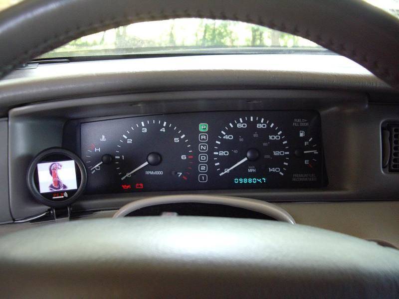

Mounted my new gauge today.

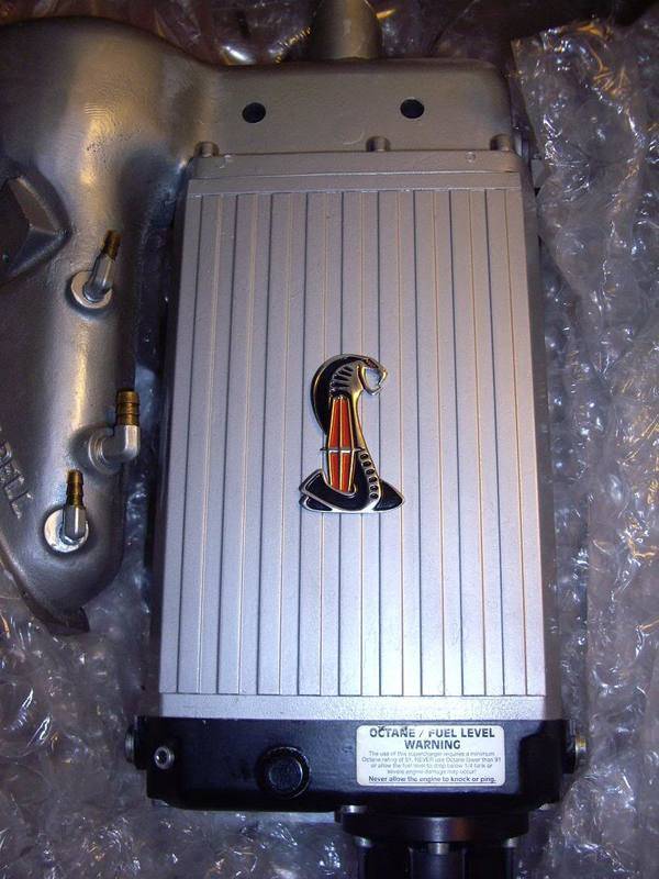

I hope to get a Procharger by next spring, but all corresponding mods should be completed by the end of the year. That Kenne Belle is looking much better than when you got it Laser.
