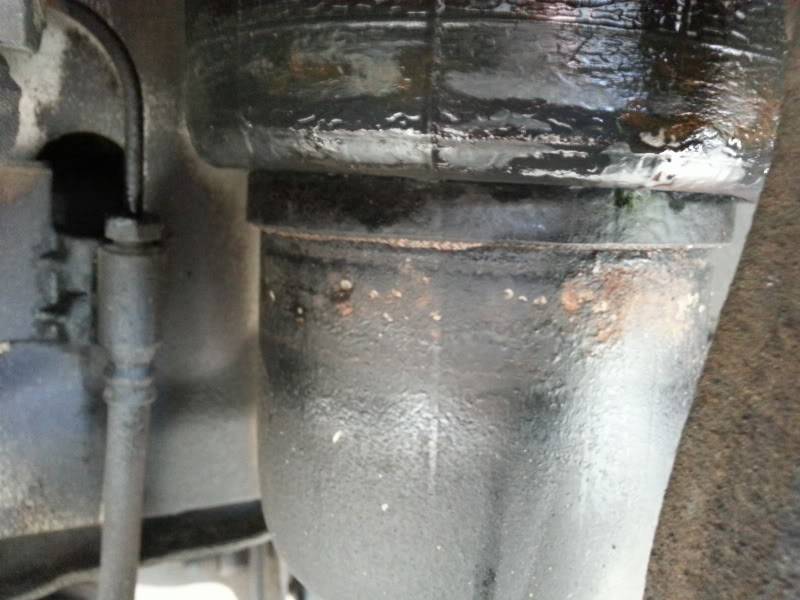

Just went and soaked the out side of the bags with a solution called Snoop(a leak detector that bubbles when it finds a leak) and no bubbles.........Shot some up at the solenoids too and no bubbles....

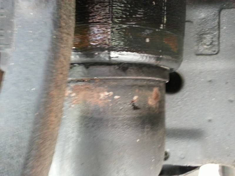

Both shocks look like this at the bottom of the bags:
they look wet cause of the leak dector.
Spray some of that stuff on the top of the spring where the crimp strap is. It may be leaking there. If not, it could be leaking at the top of the shock. Do you have the new design Arnotts with the big machined aluminum cap on top or the old type that look like OEM Gen1 air shocks? If the bag isn't leaking then it may be the solenoid or you may have a leak in the line somewhere. I just don't think a 2 yr old set of air springs should be leaking yet. And my Arnotts were leaking around where the solenoid plugs into the top of the shock because the port was slightly deformed. I had to reshape it with a pair of channel locks to get it to seal. Could be lots of things. May even be bad height sensors. :confused:
They have the machined aluminum on top, I tried putting some detector down there from the top and couldn't see anything. The solenoids were a real tight fit when I put them in new, maybe the seals went bad? I haven't touched the bags or solenoids since I put them in, so I don't see how....but maybe.

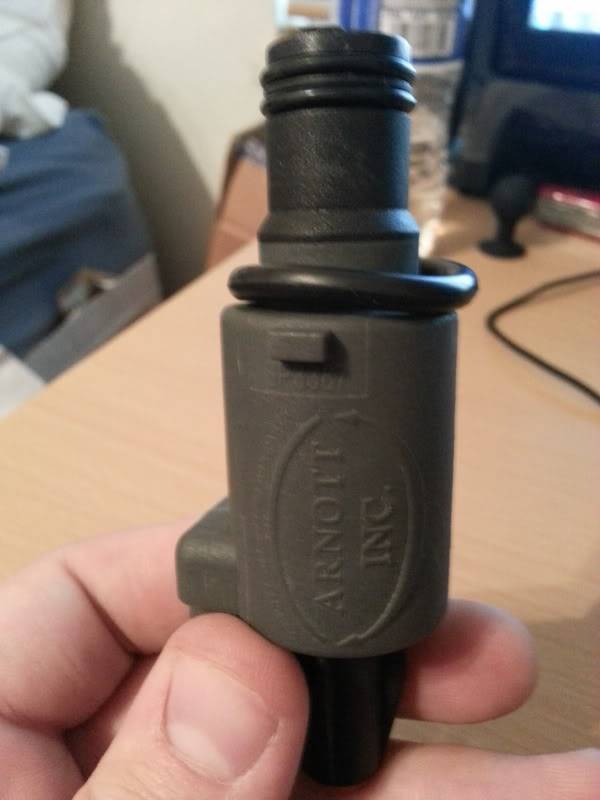

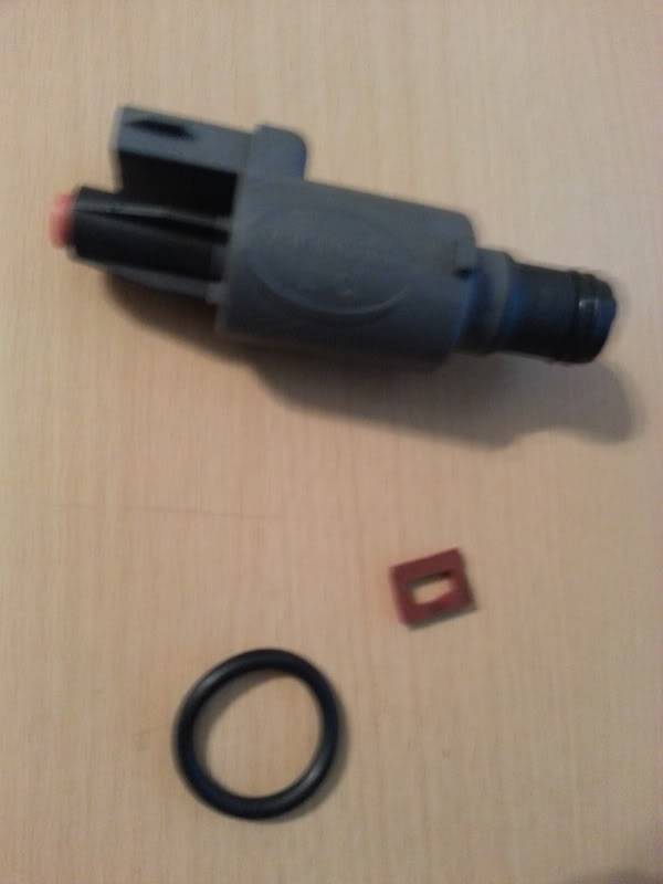

I have a brand new set arnott solenoids in the garage I'll put them in and see what happens. Can someone refresh my memory on what the big oring is for?
Maybe this?
Don't use that big o-ring. It's not for a Mark VIII. The rear bags on the town cars have those on the solenoids.

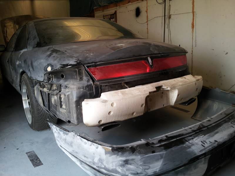

Fixing a couple areas (like 30) , sanded down the rest with 320 grit, then I'll shoot the entire car. Gotta mud over the hood first, and still haven't smoothed out the fenders or passenger door. The door has a series of very faint dents from morons at shopping centers. For the most part all of the "major" stuff has been dealt with as far as I can tell, I'm sure Black will reveal the truth
Next week I'll be pulling the side molding, side mirrors and handles, front bumper and lights
sounds like a good time to relocate the gas tank filler behind rear pass corner light, then fill and sand where the door was
