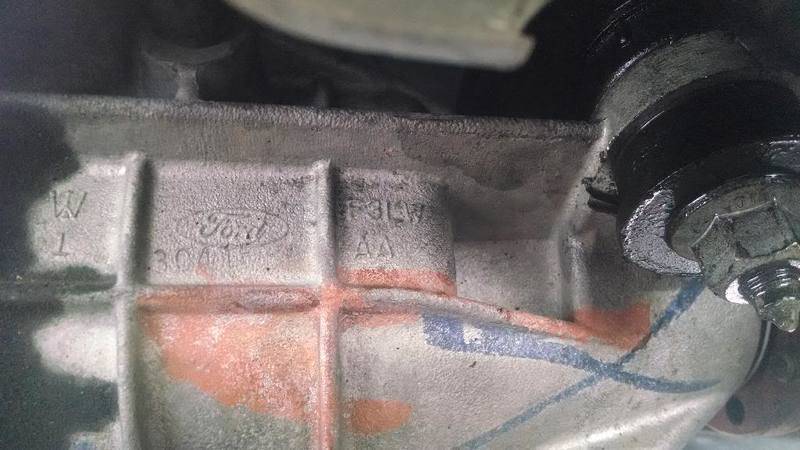

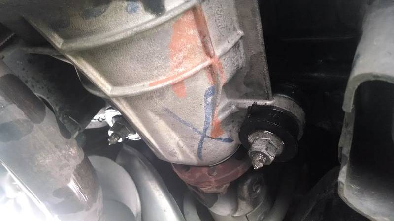

i found out whats making my driveline clunk today, i can lift up on the diff about 1/8 inch and has a very hard thud sound just like when im driving. only problem is i called autozone/napa/advance etc.. and nobody carries these bushings.
and from the markings on the diff im thinking its been replaced
im about to look on rockauto

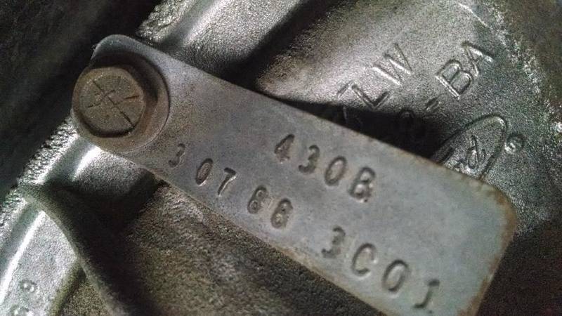

what does F3LW mean? does the L stand for locking?
The F3LW is just the part number, it doesnt mean locking. Trac Lok is denoted on the tag on the cover, if your tag was a Trac Lok for example it would read 3L07.
-Alan
-Alan
thats what i was thinking. thanks looks like ill still need to get a trac lok then
IRS differential bushing, I am not sure if a parts house will have them, but you may still be able to get them from Ford for a 2004 Cobra.
