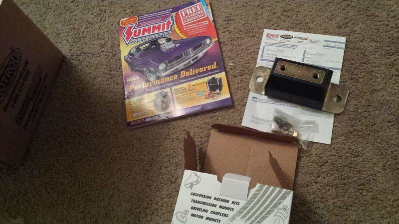

I got my part today! And I learned something new about my car apparently it has been painted in spots
http://postimage.org/
I don't see the bracket in that pic, looks like the wrong one
Part # 4-1104G is what you want
This link works for the correct Part #, I went and looked at your "Hey Guys" thread, don't know why that link isnt for the part I looked up. You can totally blame me, my bad bro.
http://m.summitracing.com/parts/clp-4-1104g
Summit is renown for their customer care, I'm sure it shouldn't be an issue to return and get the proper one, just make sure you get the kit with the bracket in it. The link doesn't specify if its included or not

No biggie, I appreciate the help figuring out which part it even is, they are too lazy to tell me here.
So do I still keep the part they shipped me and just order the bracket Part # 4-1104G? Or is that part # both together and I am unable to order it separately, which means I have to return and order that together?
Return the one you received, and order # 4-1104G With Bracket. There is an option to get it with/ or without the bracket, its a $10 difference, but you Need the Bracket
A $10 difference? do I have to ask for it extra? This is the original you linked me in my topic, and the is the one you just said that looks like it comes with it, they call it an insert, it's a $5 difference.
$32.97 http://m.summitracing.com/parts/ptp-6-1604-bl
$37.97 http://m.summitracing.com/parts/clp-4-1104g
Sorry about being anal just trying to be 100% sure
4-1104G with Bracket/Insert

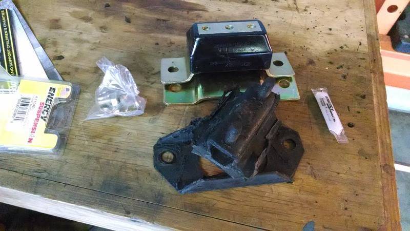

Make sure you lube the little rubber part that touches that insert, or it'll squeek on very smooth roads
Yeah, my kit did NOT come with the lube and the instructions didn't mention using lube. I bought mine from Summit.
Dielectric grease is pretty much the same stuff. I have never had the trans mounts squeak without any but I guess it is possible.

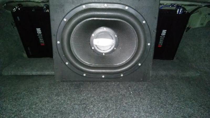

Repositioned my amps and sat the sub farther back in the trunk
Looks kinda wicked with the trunk lights off, each amp has a red square On light, looks like 2 red eyes staring out from the darkness
Now I wish I still had that black plastic piece that hides the rear of the seat, would be a perfect look to trim it out so just the face of the amps could be seen. I'm sure I'll find another one, one day
