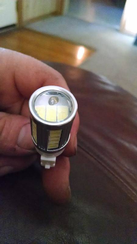

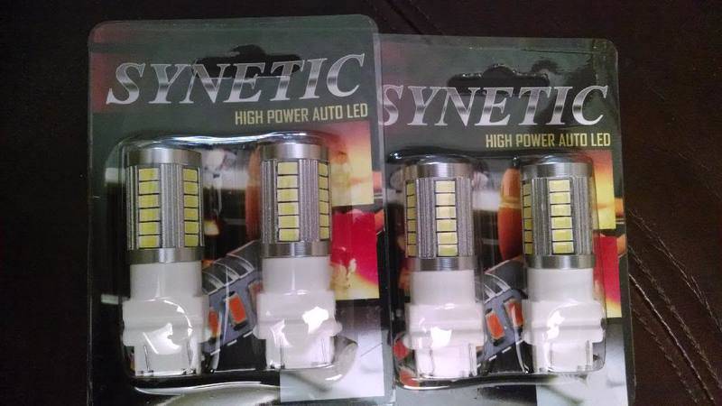

And these babies showed up, for my Front Cornering lamps and Reverse lamps..
$65 for the 2 sets

I have similar ones in my daily car's fog lights. They were not as good as I would hoped, curious to how yours do. Amazon?
I bought some of the Cree LED for my reverse as well, but I bought mine off eBay and I think it was Samsung brand. I think it was $32 for two.
Mine are bright as all hell on reverse. I was going to buy some for my corners too, but I don't think the guy I bought them from is selling them anymore on eBay.
