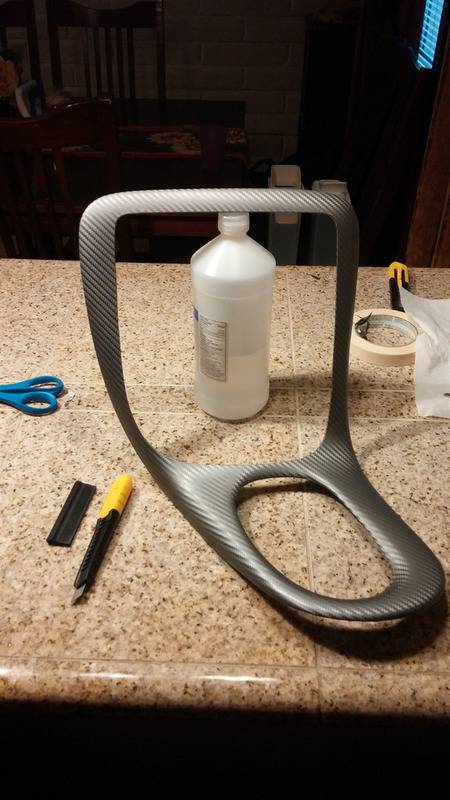

Got a nice clean wrap this time. A couple of air bubbles came up after being in the car for 4 hours at 150 degrees, but they came out poking them and going over it again with a squeegee.
looks decent Thaywood. Posting for his father eh? Anyone wanna take guesses on the mileage with me? I'll go first. 87,567

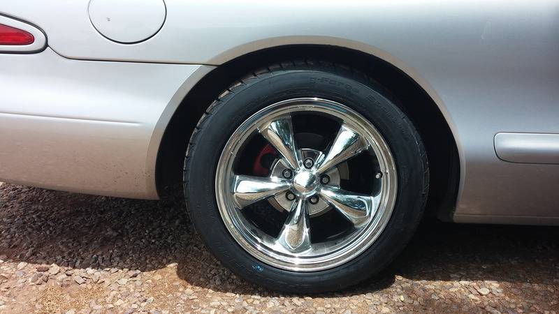

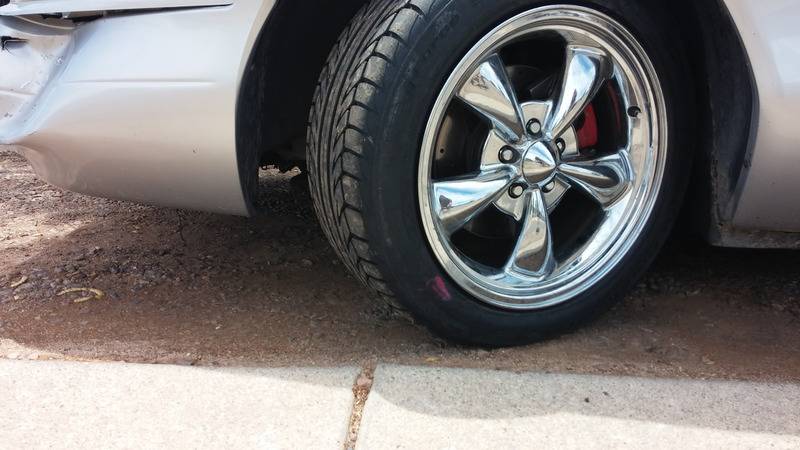

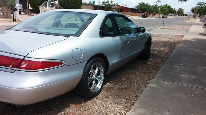

Baby needed new shoes. The well worn out ones finally wouldn't hold air for more than a few hours. I had 255/45/17 in the rear, and 245/45/17 in the front. They were on my Cougar when someone did a left turn in front of me when I was doing 45. I slid the tires for quite awhile, long enough to wear through the steel belts (first 2 inches on the inside of the tread and about 8 inches long). I drove like that for 7k miles, but the steering wheel shimmy finally made me swap one of them out.
So knowing it wasn't going to get totalled, and having saved 1750 of the insurance companies money by doing my own work (well, I am only 80% complete), I decided they could spring for some reasonable tires. Only had a few more days fro the 70 reward card for buying 4, that brings the price down to better than I thought I could do. I think the rest of the insurance money is going towards a scooter.
I looked for an asymmetrical UHP or MP tire, but only asymmetrical ones I could find were all seasons, and not really something I wanted for my driving style. So I ended up with the BFG G-Force Sport Comp2 in 255/45/17 all around. Plenty of space with the spindle up front and at full lock, already know what 255 in the rear is like (load up 3 people, and have 200 pounds in the trunk, the tires can hit the top of the fender if hitting a big bump at speed). At least without the stagger I can rotate front to back.
Once I get time to toss on the bumper/headlight/header panel and wash it, then some better shots will be had, not in the shade with a filthy car.

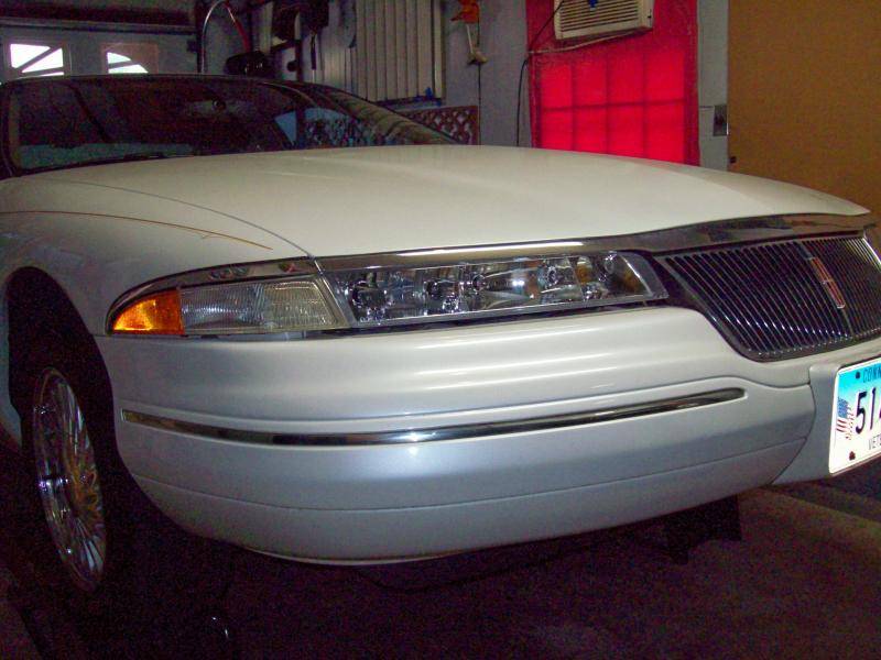

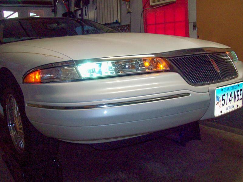

Since I had the header panel, headlights, bumper cover off, decided to install the relay harness with resistors to...see if fixes my SCIL from dying when turn on the headlights 5% of the time, restore being able to use autolamp.
So far, so good. If I let the headlights fire before starting then it is good, no flicker no error no drop out. I think I get in a state where I have to remove the key if I try to start when they are firing. The relay harness isn't all that great, the wires are pretty pitiful, and I need to remove about 3 feet of wire from the harness to the passenger side ballast, but the car has also sat for awhile and possible the battery wasn't up to it yet. But it was pretty cheap and even the components and connectors and 75% of the wiring is fine, but I might need to up the feed to the relay from the battery.
