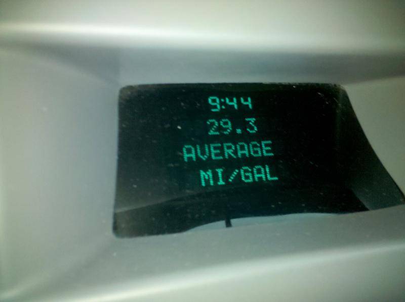

ehh ya know, this and that :rolleyes: and the millage was after a 2 hour drive to peoria, i dunno what the kid did but it was magic!
hmm got really frustrated went out and sat in the drivers seat,closed my eyes,gripped the sterring wheel and made sounds that would represent a hot rod like laser,roadboss,or mschultz car.then i woke up.
chicken I dont live but 10 minutes from peoria. were you visiting chris? nice ride by the way.
