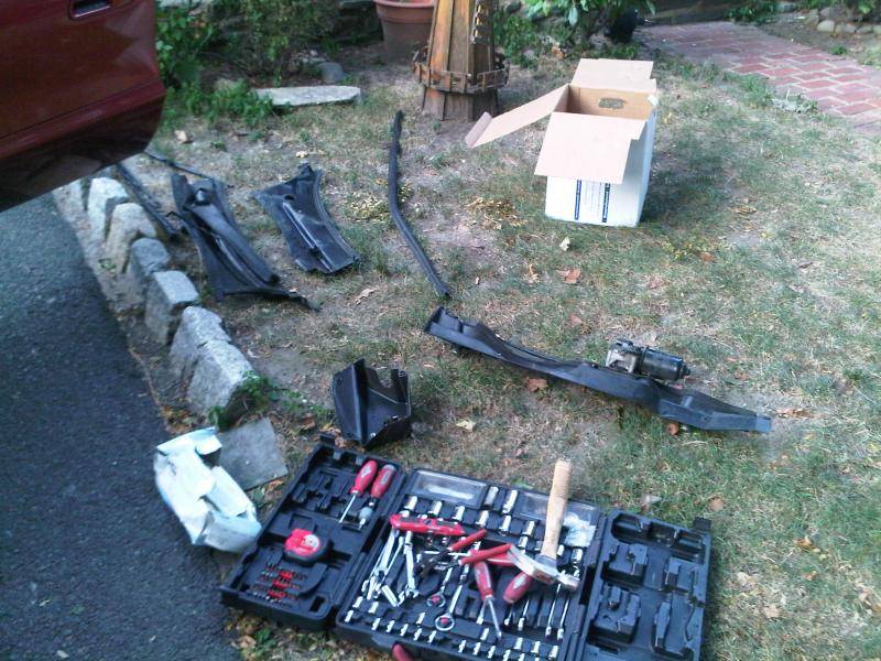

Rear trunk accessory tray came out as promised. I have an unused radio antenna lead behind the JBL amplifier. The lead from the actual antenna seems to go down in front of the wheel well along with what looks like the power leads for the ant. itself. Why the lead with no obvious use? Is it for cars w/o a CD changer- or no JBL system? Everything I have worked on so far seems intuitive - one of the things I have always liked about Ford products. Well, except for the balky memory seat function. That seems to be haunted by the ghost of Jac Nasser.

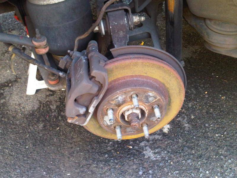

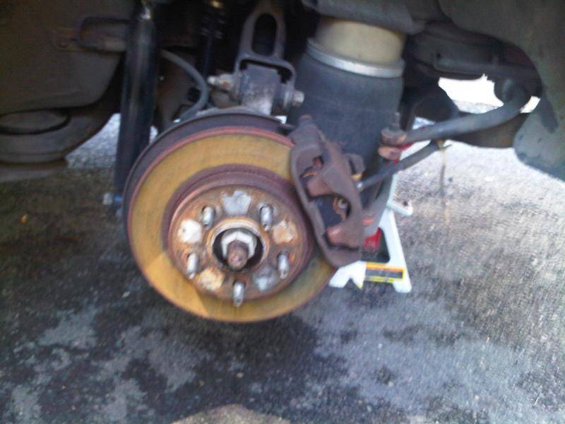

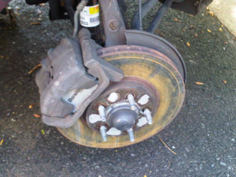

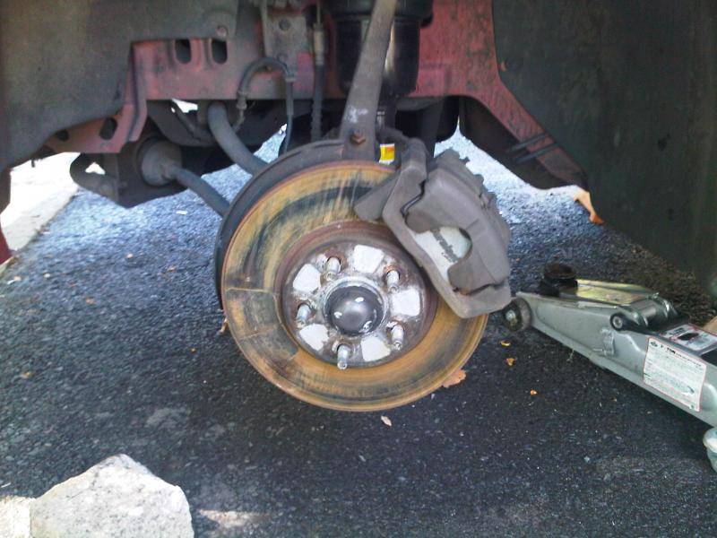

Wellfinally found some time to rebuild all brake calipers and why I was at it, I painted them a nice bright red. this little project started on Saturnday at 12:00 stopped for the night at 7:00PM, found I blew a seal in left front caliper(one I just put in, Faulty) had to pull it back off and rebuild a second time.
on the left front caliper, the sliding hardware was seized into the bracket, played hell to remove it, cleaned out the bore and thankfully, I had planned on replacing all of the hardware from dust boots to pins, ETC.. I was prepared. Also on the passenger rear same thing. seized slide bolt. no fun.
Anyway I have a few pics of the started process, I will upload finished pics once I get her cleaned up again.

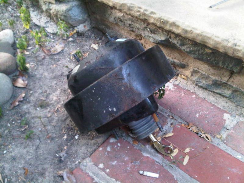

Oh and had the fun of replacing the power Booster as well...
Make sure you clock those rear caliper pistons the right way ;-)
Sorry, What? Clock them? are you saying to make sure they are properly placed on the correct side so they infact squeeze the pads instead of open up? I didnt really think you could reverse them. :)
On the pad mating surface of the piston, there are 2 divots that need to be at the 6 and 12 to align with the nipples on the pad or it won't sit correctly
open up??? If you don't put the caliper on the correct side, the main problem you'll have is bleeding them, it would be impossible to bleed them out with the bleeder valve on the bottom...
There is several things that need to be done whn doing rear calipers...the piston must be rotated back into the bore because of the actuater screw, it's must be clocked properly when fully seated, did you rebuild the rear calipers or just the fronts?

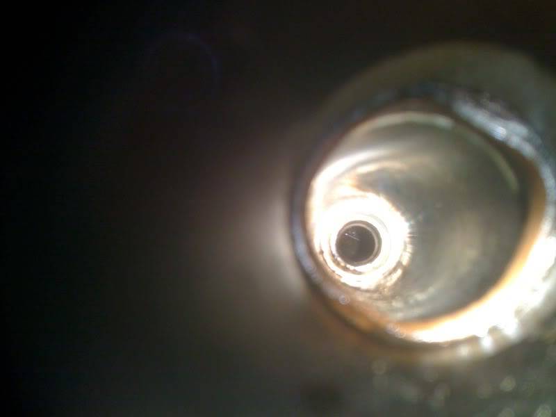

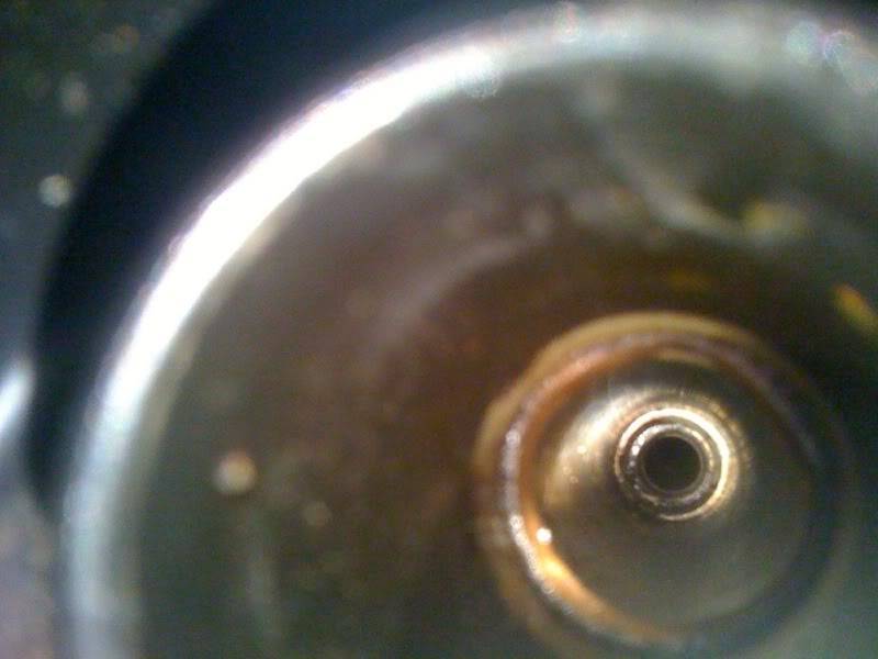

there seems to be plenty of Coolant inside cylinders 7 & 8, wonder why she keeps overheating....because this stuff is the Devil!!
if you have a "neglected" cooling system, I don't recommend using any chemical flusher addatives...I tried this bottle to help remove some rust residue from the crossover tube and overflow bottle...it did THAT fine, as well as washed out residue that was in the water pump (causing water pump to fail) as well as finished washing out residue in the head gasket (causing head gasket to completely fail)
So far just the fronts.. I am tackling that job another day.. ok I am aware of the piston being screwed back into the bore, I just wasnt sure what he meant when he said clocked.. as far as correct side yep got that covered.. the caliper is labled LH/RH pretty easy to figure out.
