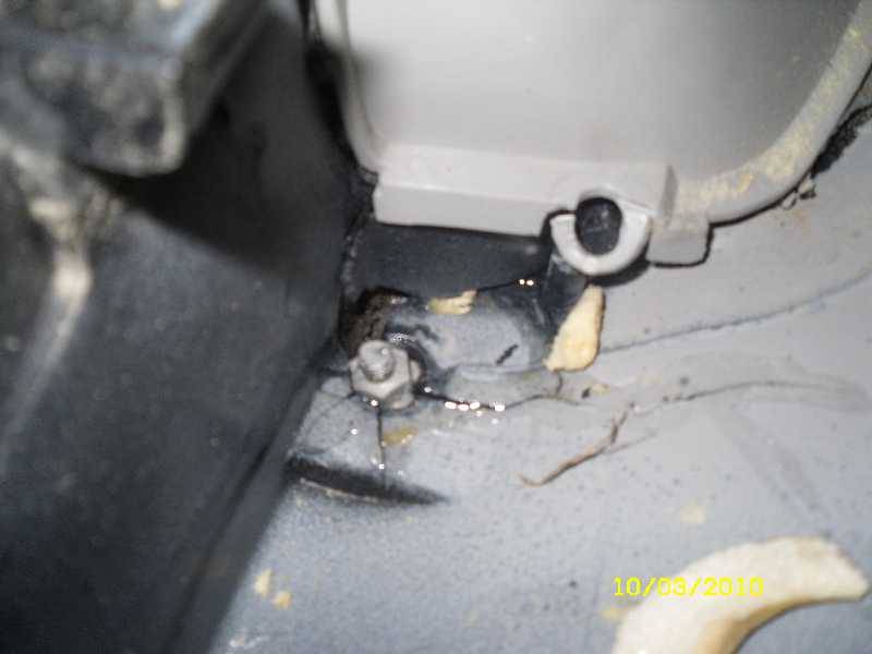

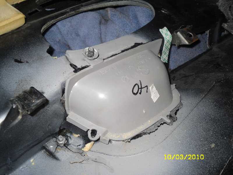

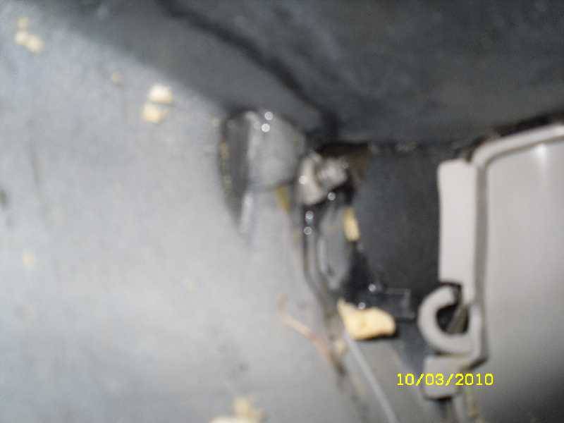

Rotated my tires on the '96 and tried to fix my p/s door panel. The pull handle has been acting like it's trying to pull free so I took the panel off to see what the problem was. Turns out the plastic around the door handle has started to crack all to pieces. I put Gorilla super glue on all the cracks and I'm going to leave it over night to see if it at least shores it up a little. If not, I need a door panel. Has anyone got a GEN1 p/s door panel in light grey they can sell for a decent price? The cheapest one I could find on fleabay was $75 plus $55 for shipping:eek:! OMG I can't afford that! If not, I'm thinking of trying some fiberglass cloth to reinforce the inner door panel. Any help would be greatly appreciated.
Here's what I'm talking about:
Anybody else ever had this problem? I didn't want to start a whole new thread on it so I just asked here. Thanks again.
You should definitely fiber glass that. It looks easy to get to and its way stronger than glue.
Yeppers. That's what I'm planning to do. I'm going to get the fiberglass cloth and resin on my way home from work today and work on it when I get home. Hopefully it will be ready to re-install tomorrow. I've also got to get some contact cement to put the vinyl upholstery back onto the plastic since it's come loose. Also, my "door ajar" warning came on the other day and hasn't gone off yet. I've WD-40's the hell out of the latch and it's still there. Anybody know where that sensor is? While I've got the door panel off, I may as well try to fix that too. Thanks.
WD-40 never worked for me either. By the hinges, there is a plunger with a nut around it. I turned the nut about a quarter turn to the left and the door ajar bs went away.
Aha!!! I thought that's where it was. I messed with that plunger some yesterday. I didn't turn it, though. I just sprayed it and punched it in vigorously a few times hoping it would losen up a bit. I'll try turning it this time and see what happens.:)
Edit: It didn't work. :(
