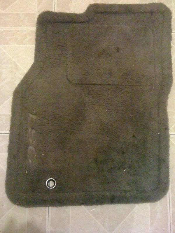

Picked up a few parts for mine and Lasers car today..my local salvage yard came thru with some rare floor mats for $1.00

gonna drop them off at the cleaners tomorrow so the light stains will be gone :)

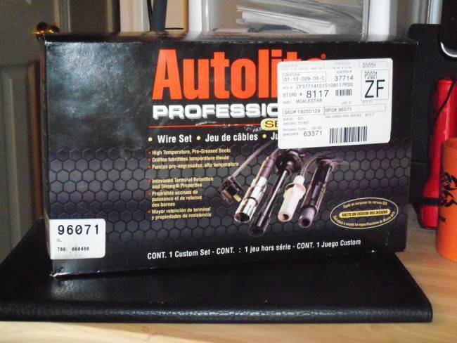

I finally got some new plug wires for my Mark VIII and will be installing them tomorrow morning. :D

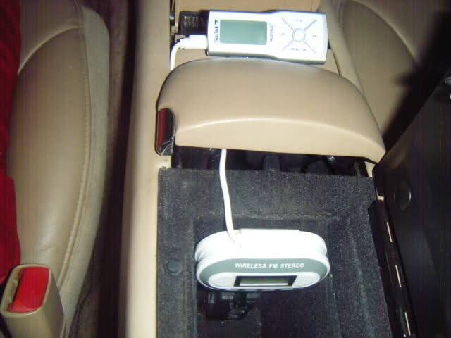

rerouted my fm transmitter wire through the cellphone input panel in the armrest..God i love stuff thats hardwired..I hate f'n wires and chargers all over the place..To date my transmitter, radar detector and gps are all wired in that manner.

Would you mind posting some pics or sending me a PM on how you did that? My wife uses an FM transmitter to play her iPod and it would be nice to have it hard wired. Thanks.
feed the power wire through the cell panel or drill a hole if you dont have 1. Press in the tabs on both sides and it will pop out.
ran the wire through the cupholder as i never use it. I figure it wont break if its never open.
run the power wire(cig jack) under the consel and above the black panel by your knees. There will be a space were you can feed the wire from the back once you reach the fuse panel..
buy a $4 "add a fuse" or something like that to a switched 12v source as seen in the pic. I used the upper left bolt as a gound for all 3 of mine.
To hardwire it using the cig plug you'll have to open it up..You'll see a power (the nipple part) and the ground (sides). tap into those leads and run the wire to the fuseblock. You have to keep whatever is left in the cig lighter jack as it will contain resisters and such..When i opened mine up i just discarded the "nipple" part of the jack (screws off). And run the wire through the now empty hole.
hardwired, hidden wire for all.
The only one i didnt have to use the cig plug with was the radar. i just snipped it and ran wire to the fusebox. I would not recomend this..I got lucky and it didnt blow.
