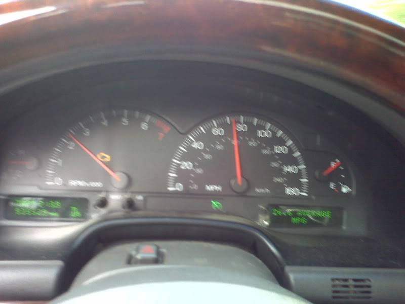

who mpg's high as mine (not really asking)
Yea I'm usin the onboard computer, seeing how the pic iiisss of the oonnbbooaarrdd ccoommppuutteerrrrrr...lol. It stayed at that reading for a while until I hit just under 3/4 full

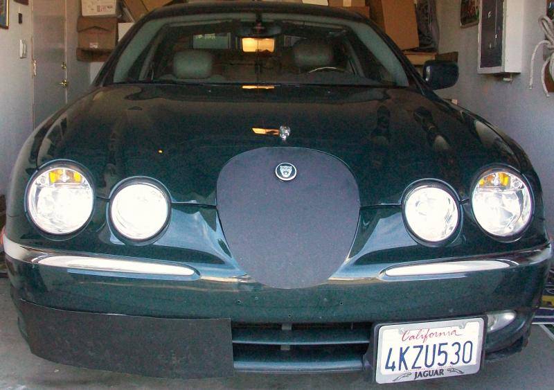

Modifications that have a proven positive impact are aerodynamic modifications and reducing weight. Aero mods: lowering the vehicle, grille blocking, passenger mirror removal, full belly pans. These changes work best at higher speeds but do make a noticeable difference. Weight reduction is less noticeable but still has a positive effect.
I am somewhat of a fuel efficiency buff and keep fuel logs for all my vehicles. I have achieved a best single tank average of over 36 MPG and have a lifetime average of over 27 MPG in my 2000 S Type 3L SE. Currently my fuel economy average is over 28 mpg. The mods I have done are 42 PSI tires, grille blocking over the upper grille opening and about 1/2 of the lower grille openings, right side mirror removal, front wheel deflectors and keeping unneeded stuff out of the trunk. I'll probably add a streamlining panel under the engine to further smooth air flow under the car. I made all my aero mods and they are easily removable if I need more radiator cooling airflow or need to use my fog lights.
Some people will disagree with my efforts which is fine, I have a thick skin. The S Type is a great car; beautiful, fast, luxurious and efficient. I hope to enhance its efficiency without degrading its other qualities. This is what works for me. If you drive smart, keep your tire pressures up, and keep your car well-maintained, sleek and light you will be rewarded with good fuel economy. I hope you find my suggestions to be helpful. Please let me know if you want more information on getting the most fuel economy out of your Jag.

Not to sound like a d*ck - and most of your methods are certainly tried and true hypermiling techniques - but anyone who would stick ugly black plastic over their grill (and a half) and remove the passenger mirror from a Jag, doesn't deserve to be driving a Jag. Buy a Jetta TDI and get another 20mpg without having to bastardize your car. It's probably faster than a 6cyl Jag too.
But you left the leaper on the hood! Think of all that extra drag! ;)
That jaguar deserves to be shot. It looks like it has rabies or some other wild animal disease lol (I never liked s type jags) ::takes shotgun and aims::

My point in posting wasn't meant to focus on aerodynamic modifications that change the looks of the car, but rather to point out the inherent efficiency of the LS/S-type platform. Without aero mods I could average 27-28 mpg very easily and I wanted to encourage those interested in getting better fuel economy to look at the no-cost details that allow it ( higher tire pressures, efficient driving, good maintenance ,etc.). Its good to hear from many LS owners that are getting better fuel economy than the EPA rating.
During the last round of $4/gallon gasoline, I saw many people sell larger cars and trucks at huge losses to buy smaller vehicles in an attempt to save money. For most of them , they would have been much better served by keeping their larger vehicles and investing their efforts in making it perform more efficiently.
I understand that my simple aero mods are not appreciated by some. In my own defense they are easily reversable and I can return it to its stock appearance in less than a minute ( other than refitting the mirror). The aero mods are essentially experiments that I have found to be working and now the challenge is how to fabricate them in a form that doesn't diminish the car's appearance. I'll work on that and if there is some interest I'll post some pictures to illustrate how these aero mods can be better concealed or integrated.
OBTW, the "SARS jag's" last 2 tankfills have been over 30mpg.
Cool. It took exactly the next post to rip this guy a new one. Love the hate. Love the love. All=Good.
Yup, there is no acceptable excuse for f*cking up a nice car! He deserved to have a new one ripped. If you want to remove mirrors and cover your grill with ugly black plastic to get better mileage, start with a pos car in the first place. Or don't come bragging about how ugly you made it on a forum of car enthusiasts!
