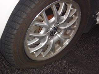

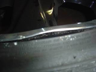

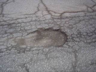

well here are the pics of the hole and my rim and one of the other guys rims. ive been calling places all day trying to find a spare and no luck they all want 175 for a rim and tire. im going to get my estimates today and send out the info to modot and god knows how long that will take.
Looks bad. Got your PM, I called and left you a message. I'll lend you mine, just make sure you get it back to me. I don't want ot be without one too long incase I run into one of those infamous MODOT holes.

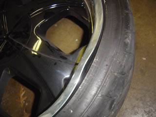

Purchase a butane torch and a large head hammer. Heat rim slightly on bend and carefully hammer rim back into shape. If this is your rim in the lower pictures this method will surely work.
You have nothing to lose; if you do it right it's a permanent repair. I cant tell but if this is the finished (pretty) side of the rim, be sure to use a small block of wood to prevent hammer marks.
I agree i think you can bend that back enough for it to hold air. i've been able to do it to worse. actually are you sure it won't hold air now? it might if you try to fill it again
I i do that ill have marks and the rim wont be perfect. I guess I could do that as a temp. fix until I find out what MODOT is going to do about it.
I called again to see how long the process takes and the lady said about 2-4 weeks. Then i asked what am I supposed to do unitl then. She said they MAY be able to get me a rental, but i'm going to have to wait until tomorrow to see whats up with that.
